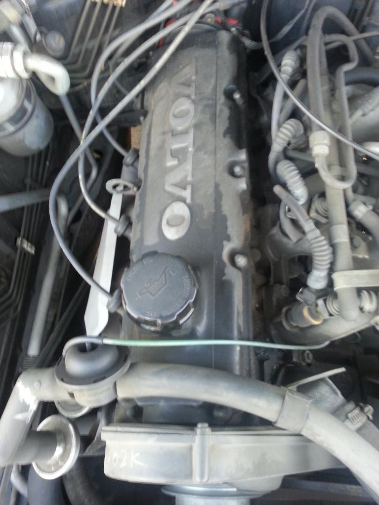

2. I noticed a little darkness or 'wetness' around the oil filler cap, not like a burn just like an oily wet spot on the area immediately around the cap, on top of the engine. It could be just some spillage, or maybe was overfilled. Is this anything to worry about?
