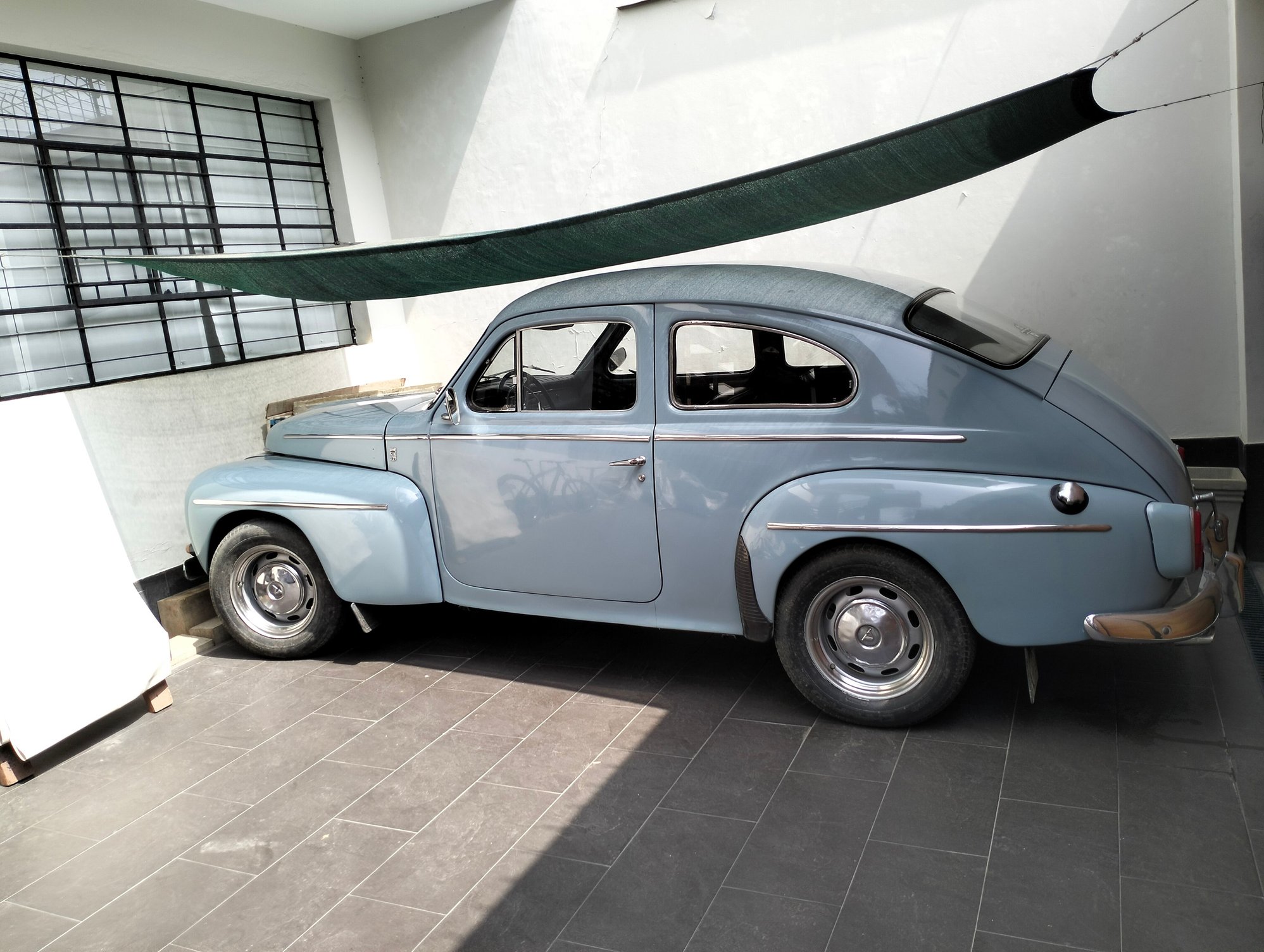

I have recently bought an PV544 ( 1964).
There is a big problem with fuel Consumption.
What would be the causes?
(recently It was tunned Up)
