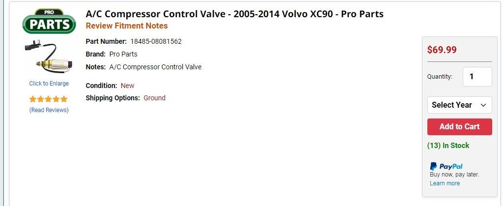

Yes my shop has replaced a bunch of the variable displacement valves when they stop working properly. 100% success rate. Those valves range in price from $70 to $200 depending on the brand and vendor. About an 1/2 hour to replace once the system is empty and an hour to evac and recharge. So a valve, 2.5 hours time, and A ~kilo of r134. I imagine the dealer would not be willing to replace the valve by itself - so you would need to seek an independent garage. (triple check the part number before ordering - there are several numbers)
Versus replacement compressor $370 plus +++
