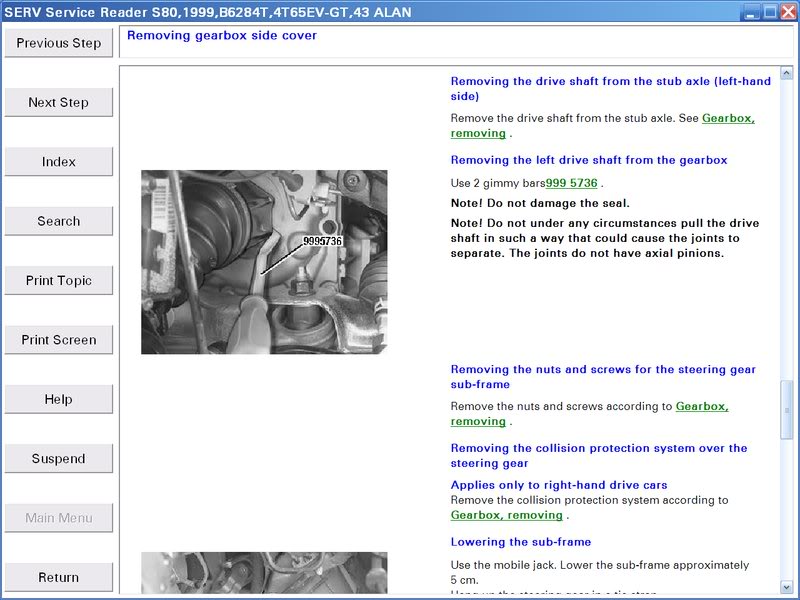

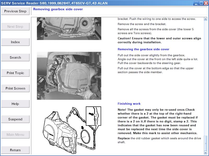

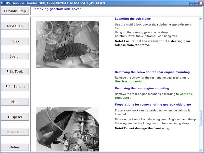

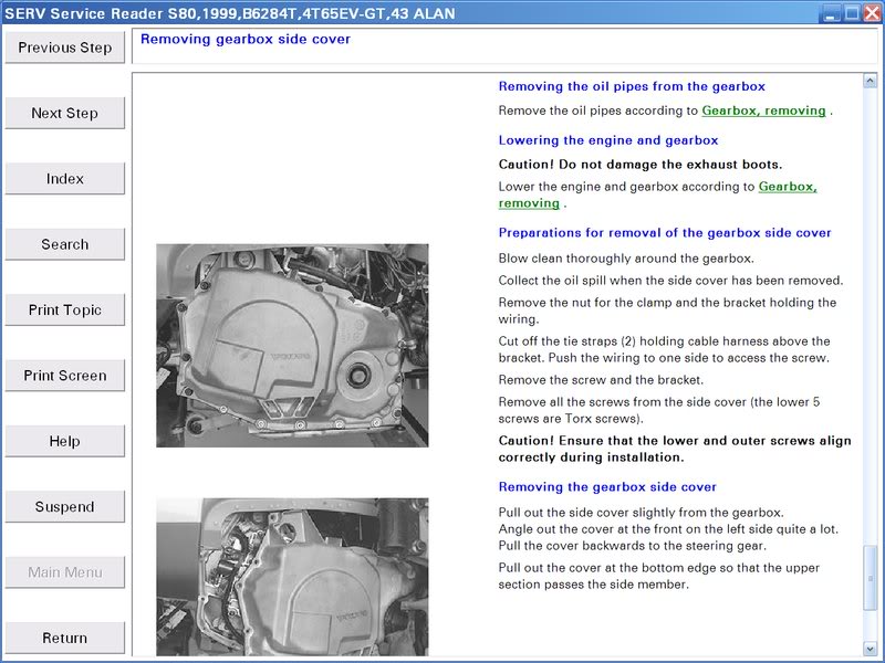

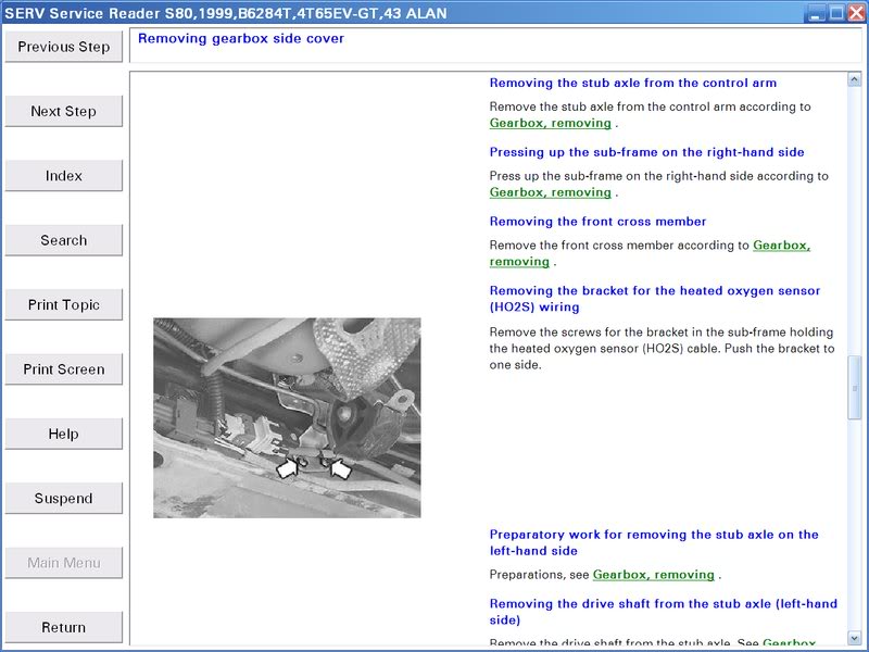

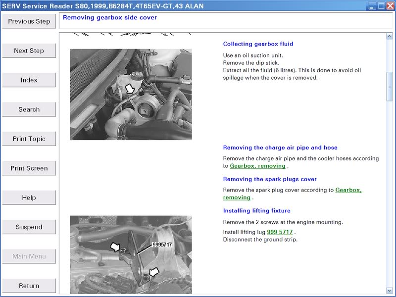

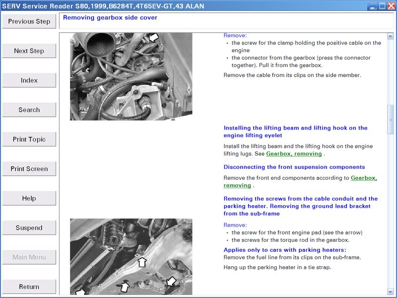

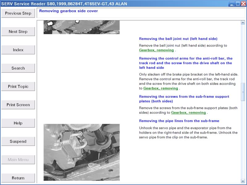

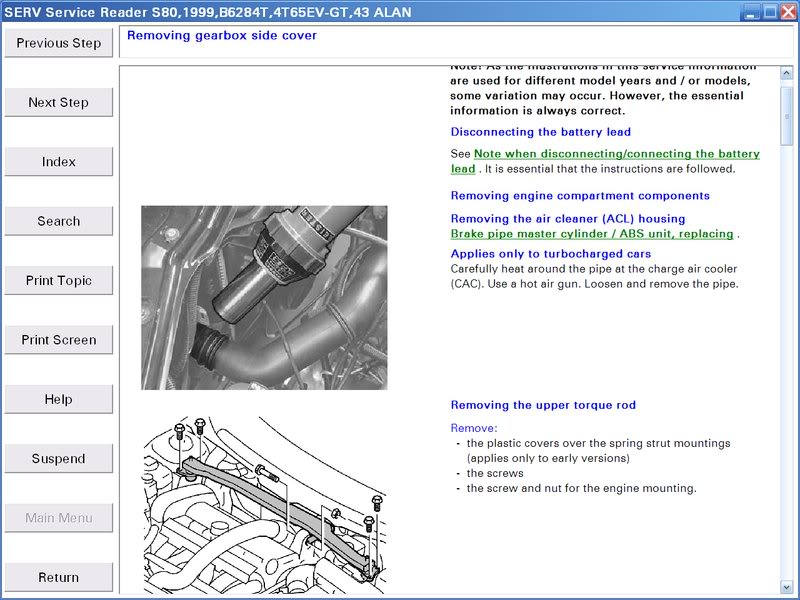

Old Nov 13, 2008 | 05:39 PM
tech's Avatar
Joined: Sep 2004
Posts: 36,349
Likes: 46
Default RE: service transmission light!!!
Here they are.

It doesn't show the solenoid but they are in the side of the valve body under the side cover.

oh my god... i cant believe how detailed that was... thanks!!! ill let you kno how it turns out. im going to wait a few days to get started on it. im gonna plan it as carefully as possible so i can just dive right in and get it done in as little time as possible... how can i get my hands on that program???

okay where can i find a lifting fixture and does this job involve a engine hoist/ cherry picker? also are there any other specific tools i will need for this job besides an array of torx bits?

You can use a cherry picker instead. You might have to make the other style hoist if you want to do it that way.
The rest should be normal tools.
