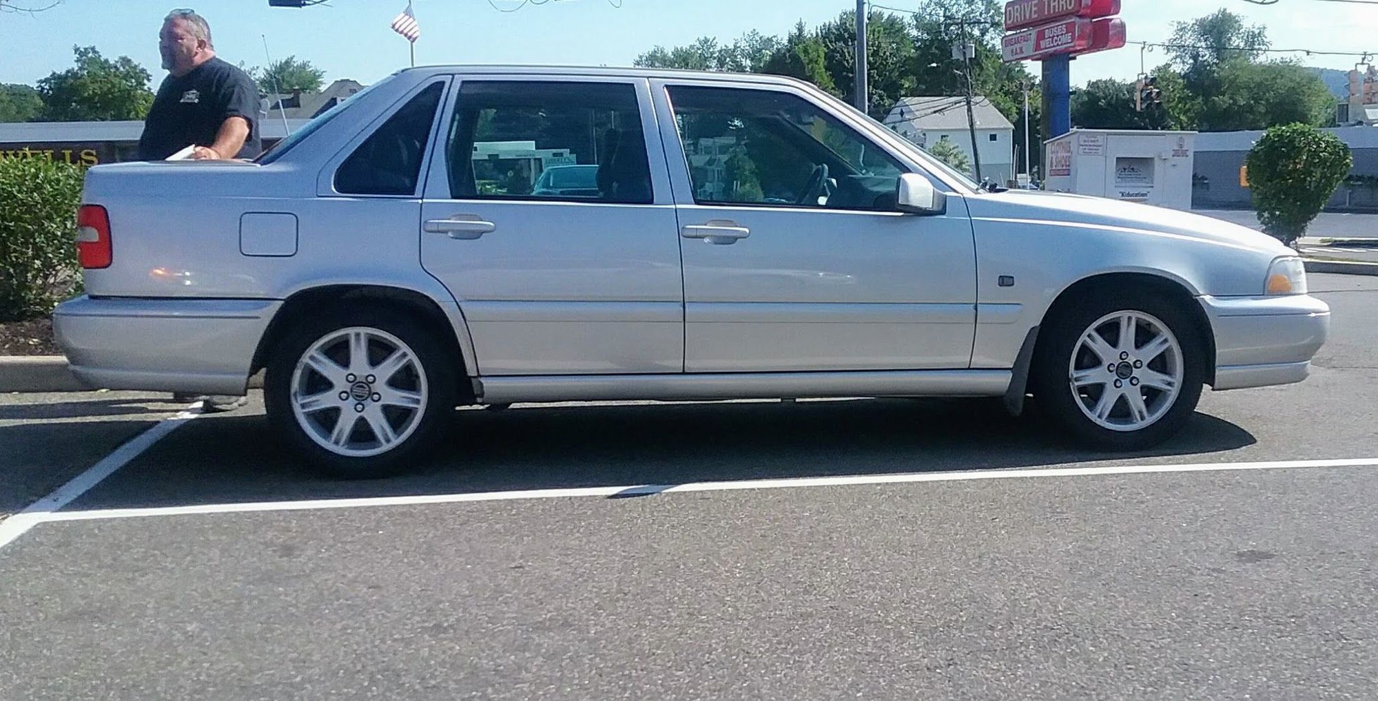

hello every one am gonna start saying that I got my 3 volvo car I used to have a 240 then a 850 wagon beautiful and now a 1999 s70 in perfect cond; my only question is this I know that my other 2 old volvo the steering was kind of harsh or stiff comparing to newer cars that u can turn with one finger but my s70 I think is a little more than what I remember from my 240 and 850,,is this normal …….just in case ps pump is good the rack is good the u joints in the steering were kind of lock were stiff at around 2 4 8 10 oclock but I got them loose up with penetrating,,,,,,am thinking of getting new set of u joints if thety sell it...….is there something else I shud look into or any tip …..thanks here is a picture of her

Unfortunately, I wasn't able to open your pic. However, I'm not sure what you mean by "u-joints". I think that you are referring to ball joints.
