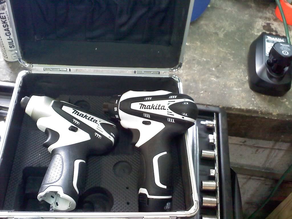

my NEW Makita 10.8V impact driver and drill arrived today!! My boss was letting me use his, but I wanted my own...these things can literary drop hours off of doing engine/transmission swaps and many other jobs. These will pay for themselves by the end of the week.
I also bought myself some Snap-on ratchets and another $70 10MM 1/4 drive flex head socket. I splurged.

Nice. Most of the time I work on the car I can't find enough room for a ratchet, I would never be able to get those guns in there.

Those Makita guns are about 3.5 inches long and 7 inches high. Have a max reverse torque of almost 100 ft-lbs in 3 seconds and max tightening force of 65 ft-lbs. Max of 3500 RPM. batterys charge from dead as a door nail to full charge in 15 minutes. Batterys last about 4 hours of constant use before they need a recharge.

Awsome on the tools.
