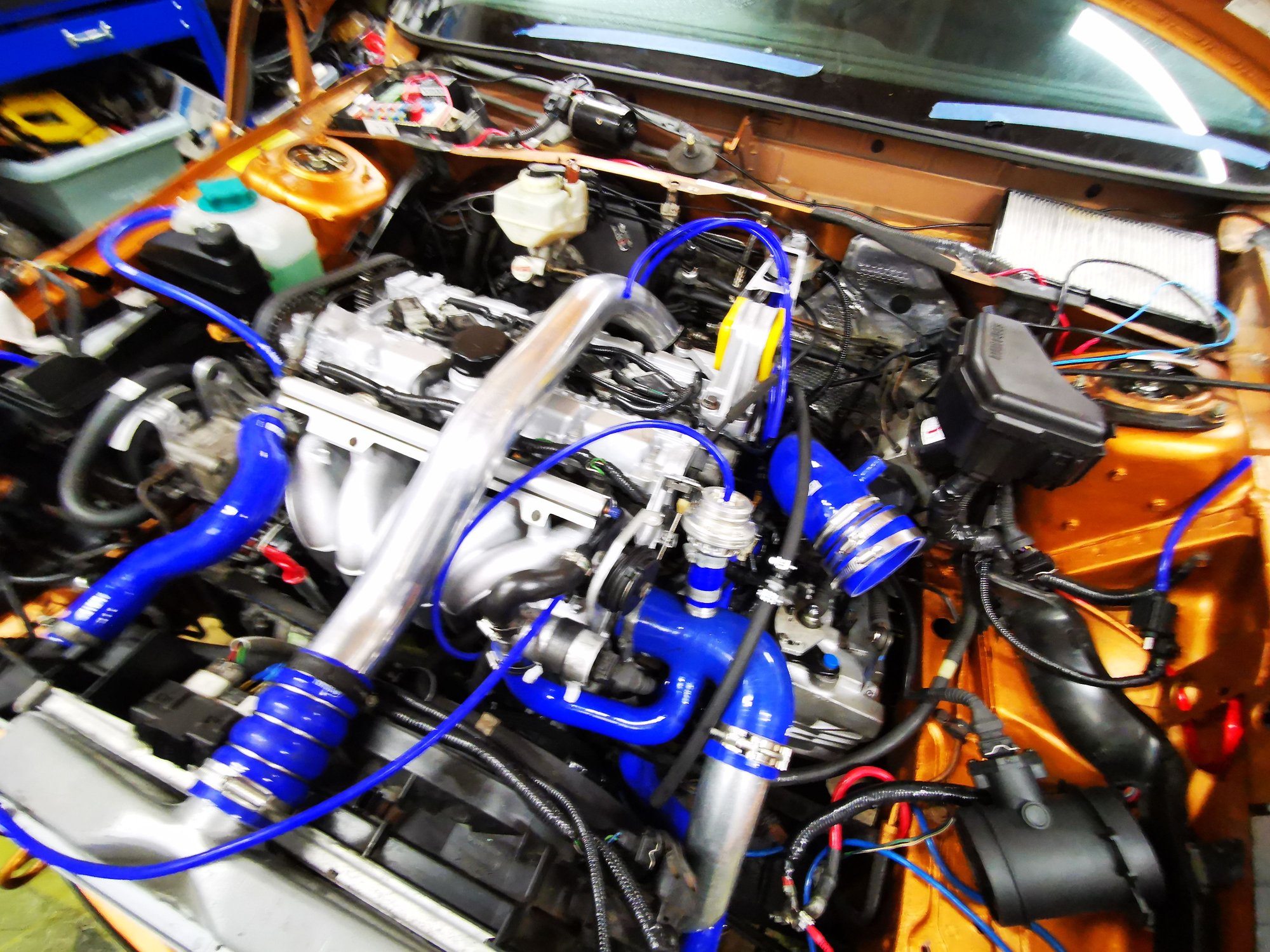

I have a 1998 V70R which I've fitted a S60R 2.5 engine into. Engine came out of my S60R with 80k and ran good. Have kept the M56 box. Fitted most of the V70R components over (22T turbo, VXR injectors, 3" intake with new PCV system, 3" downpipe (new cat or exhaust fitted atm), Do88 intercooler, V70R throttle body, standard TCV. M4.4 ECU, MAF is 3.5" from a BMW, most of the pipework has been upgraded. All vac lines are silicone, new clutch, flywheel etc).
Engine has been converted to Coil over plug using S60R bits and a custom map/ecu wiring.
Have completed a VVT delete on both cams. Belts replaced and timing set 2.3' exh anticlockwise and the inlet 6.2' clockwise.
O2 is being measured by a AEM AFR wideband.
FPR is currently a 3bar unit, was originally 3.4bar to try different things. I'm seeing 3bar at the rail with no massive drop over time.
New battery and have confirmed injectors, ICV, CAM, Crank, MAF are all working fine.
