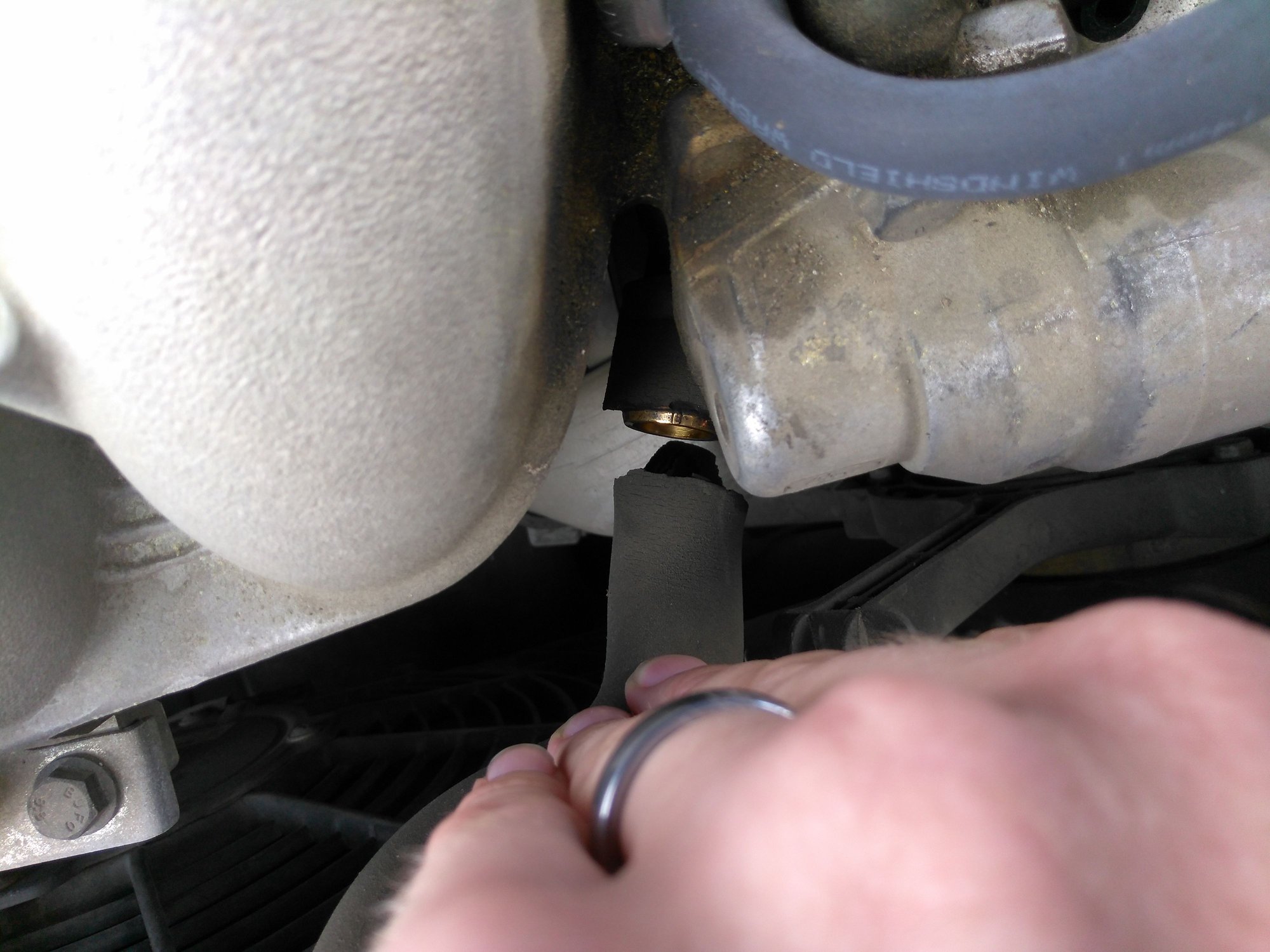

Another issue is the 1" hose that runs from the front intercooler to the throttle body. It can harden and crack in half causing a problem for the ECM. On a MAF car ALL air must be accounted for as that is what a MAF measures. However, turbo cars have a re-circulation system and the cracked hose causes a loss of air that has been accounted for with the appropriate fuel already.
I got a new one from the Volvo dealer here for $19!
Solved the problem instantly. Plus now my car has WAY more power than it did even before the total blowout of the hose so I'm guessing it was leaking pretty good for a long time. Also that "whirring" sound was the massive boost leak caused by the hose. Engine purrs like a kitten again and rages like a tiger when you hit the gas. Seriously I haven't had this much power since I bought it beginning of 2016.
