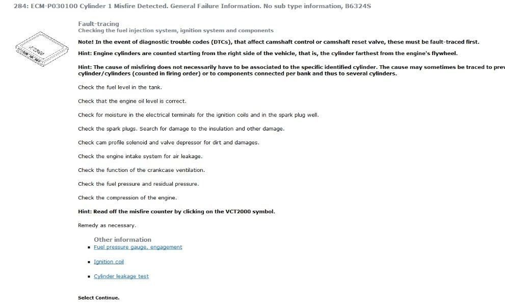

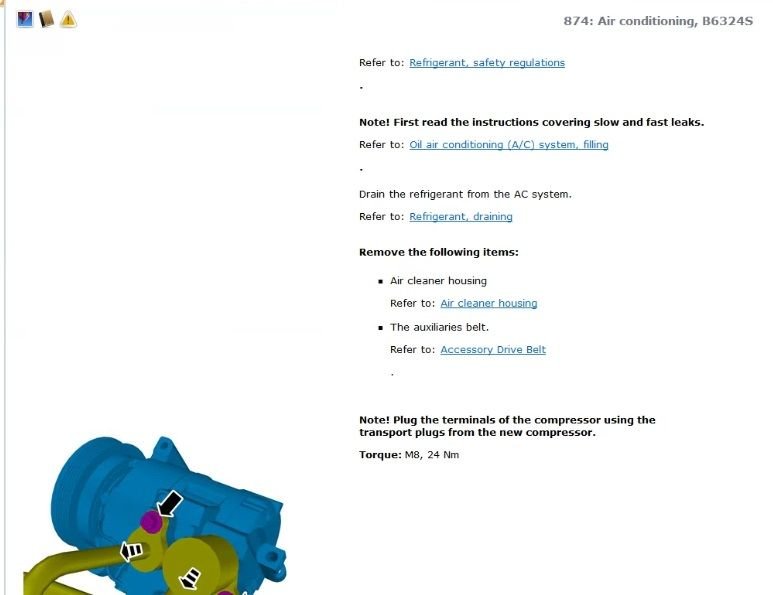

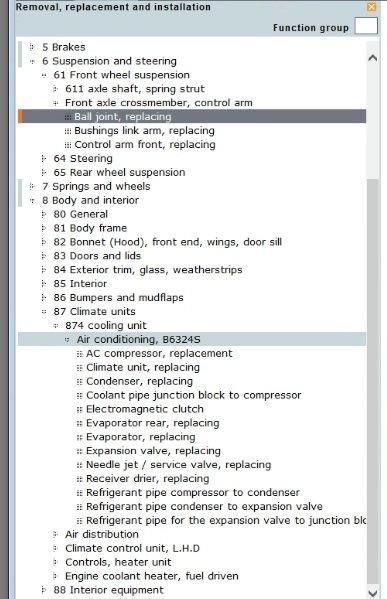

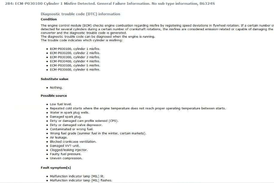

2014d was designed to work on Win7 pro. Simple install - put disc in, it copies 8 gig or so of data, apply the "patch" (hack) to get Vida to work without a subscription - and it just works. Perhaps the vmware link stuff allows you to use the software with a different operating system. Most dice units come with a copy of vida or downloads can be found easily.
Many Volvo DIYers have an old win7pro cpu and put the hacked copy of Vida2014d on it. You have parts diagrams, service procedures, capacities, torques, and wiring diagrams. (comes on a second disc but is part of the complete program).
If you want to pull codes in every control unit - you will need a DICE unit. (or equivalent) That is the interface between the OBD port and your cpu. If you have a code, you can simply click on it and Vida gives you possible causes and suggestion of how to fix them.
A DICE unit is also used to download new software, for instance if replacing a module. However that can only be done with a paid VIDA subscription and a valid Dice unit. (you won't need to do that)
There are really no printed books that are as complete as the Factory (stolen and hacked) diagnostic software. What part of the country are you in? (i have a cpu to give away)
Here's a few screenshots - anything on those pages is blue is a link to more information.
