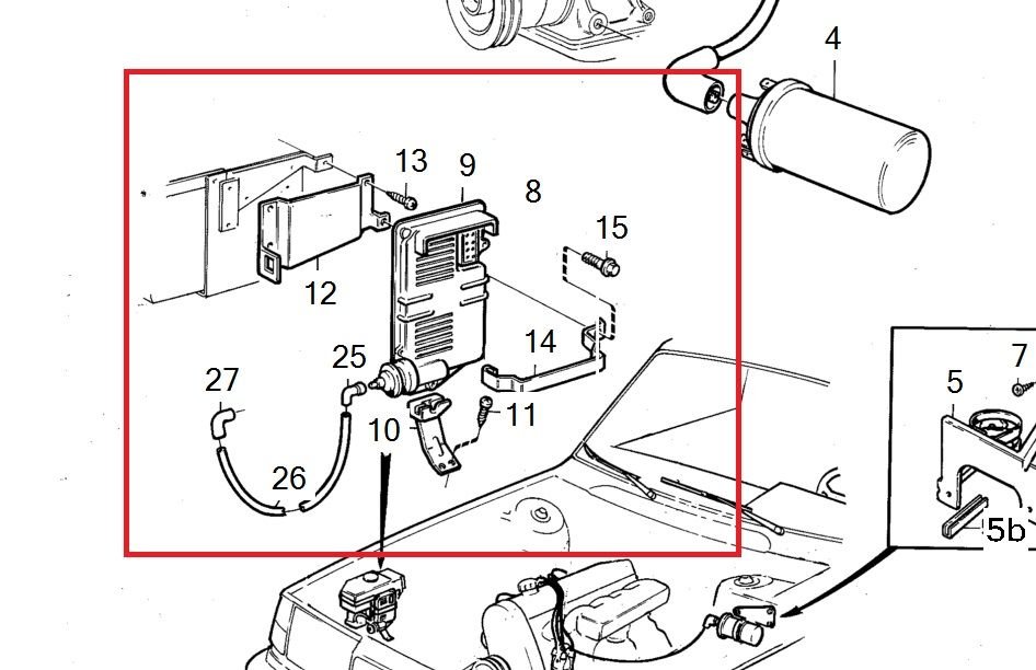

The car has been having problems for some time. Started with Intermittent stalling at stop signs/lights unless it was given gas and not always restarting immediately. Then it reached a point of not starting at all, Distributor was changed and still no start/ and now no spark.. Mechanic is looking at the ICU and ECU

The Ignition control unit is a common failure point. Sometimes it's simply poor connections where the harness is plugged in, sometimes cracked solder connections on the ICU circuit board are the problem - or for some other reason - the ICU does not work anymore. With a car that old - could even be the wiring harness to the ICE.
