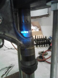

volvo s60 control arm bushing tool I made.

I fabricated the press and bought some pipes at home depo, it was very easy to take off and on. Hope it helps someone else, I know this bushing dont last very long.
Attached Thumbnails volvo s60 control arm bushing tool I made.-img_20130206_230617.jpg   volvo s60 control arm bushing tool I made.-img_20130206_230541.jpg   volvo s60 control arm bushing tool I made.-img_20130206_230628.jpg   volvo s60 control arm bushing tool I made.-img_20130206_230721.jpg   volvo s60 control arm bushing tool I made.-img_20130206_232805.jpg
