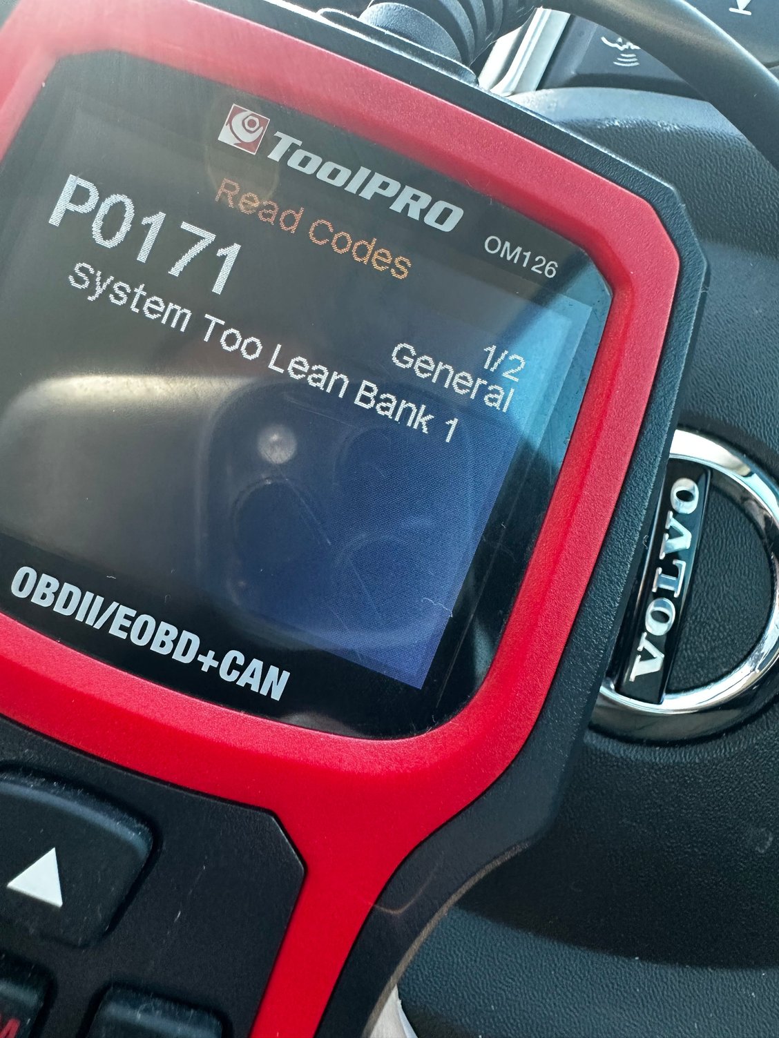

Default P0171
Im in Western Australia. My reader says it P1071 too lean
But i think this can be as a result of multiple things. Its had all it services. Had the plugs and intakes done. Mass air intake cleaned etc.
I was told it was the evaporator system which is in my first post above i think?
