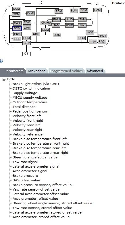

The BCM (brake control module) is not listed in your printout. Here's what Dice will talk to in my 2015 - I don't have SUM (electric shocks), PHM phone, TVM Tv module (and the other grey ones) so they all all grey. What does your module diagram look like? And note BCM is in my printed list. Is your VIDA talking to your BCM? - you should be able to click on the BCM icon and view parameters, activate, advanced -

The printout was from the fault trace tab. I went to the network tab and ECM, BCM, and DEM are red and their tabs say not responding. In fault trace ECM, BCM, and DEM are grey. CEM is red.

"In fault trace ECM, BCM, and DEM are grey" -
A few years ago I had a problem with a clone DICE I purchased - it would not talk to some modules. (in several cars I tried) The vendor sent me a replacement that talked to all of them. You might have bus problems - here's that page from the wiring book - note the brake and diff modules are on the same can bus wires/connectors into the CEM. Water damage is also common with your CEM and note the xemodex failure symptom at the bottom of the page "wont communicate with BCM"
