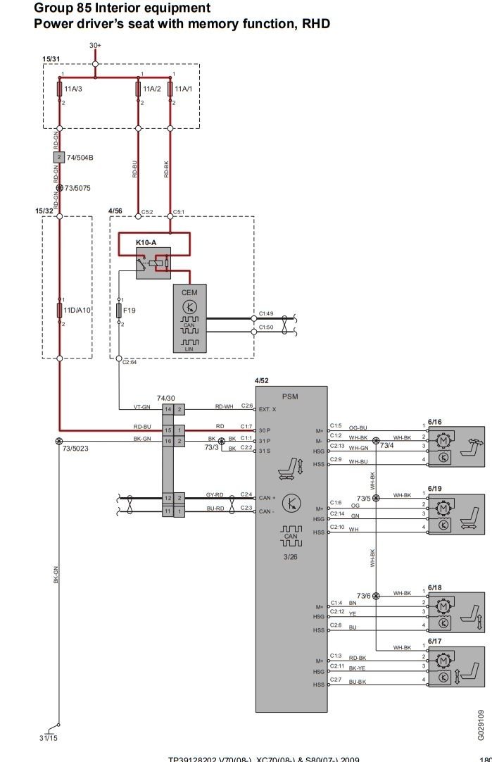

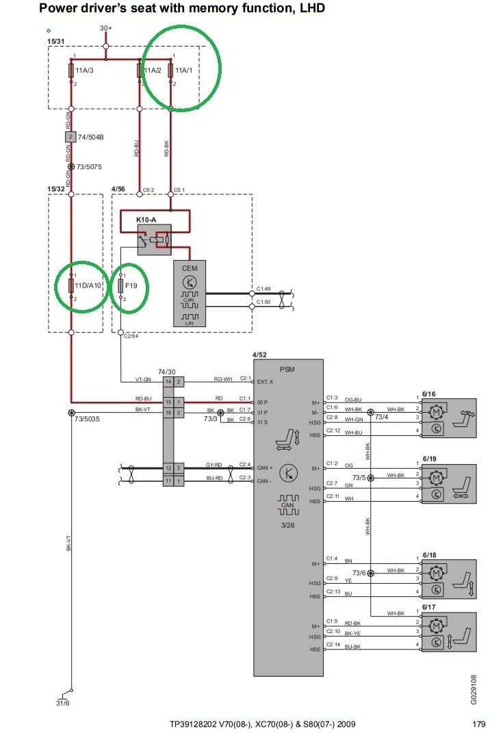

Hi all , apologies if this had been mentioned elsewhere , my drivers electric seat is dead , won't move in any direction, in addition to this neither 12v sockets work front and rear passenger , can anyone advise were I should look to investigate or came across this themselves tks , 2009 v70 d5 se
Old Mar 27, 2022 | 05:03 PM
Don't see any connection between the two items on the wiring diagrams. For the seat check fuse F19 on the CEM ( 4/56, above the passengers feet), and fuse 10 in the D fusebox (left rear corner of car, the rear electrical box). Fuse A1 is a 50 amp fuse that is powering much more than just the seat. The first 2 appear to power the PSM (power seat module). For the 12 v outlets, (9/1 and 9/25 on the diagram) fuses 25 and 27 in the B fusebox (under the hood) power the outlets and the relay (2/193) for them. 17/19 is the 12v outlet in the cargo area if equipped.

Sorry just noticed your steering wheel is on the other side! Hopefully all the electrical components will not be moved either. Can't help with diesels here in the US, they are not sold over here. .Power drivers seat looks like it uses the same fuses for RHD.
