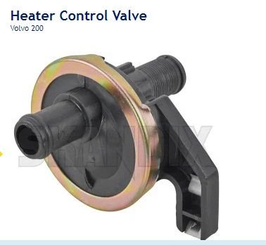

I bought the car new in 1993 and have maintained it as a singular driver since then. The car has been driven almost 233,000 miles. There is a problem with hot air coming through the vents with the temperature selector lever in the left foremost position. The air conditioner also is not engaging. This is the major problem that has not been resolved. My interest is in the experiences of other owners with this issue.
Old Aug 17, 2025 | 10:01 AM
Your heater control valve is leaking internally or the cable that controls it is not pushing it all the way closed. (earlier cars used a different style of valve than shown, there is less plastic on the earlier valves)
Ac is another issue - best solved by a knowledgeable person if you are not familiar with ac operation.

Postings on Turbobricks had led me to believe that my heater control valve and the air conditioning were the culprits. Your assessment has confirmed mine. I had just discovered Volvo Forums when I posted the issue. My August 15th service request for the Volvo dealership that repairs my car covered those issues. My habit is to find out as much about an issue before my service request is made. I find that it helps my personally selected technician and me to speak similar, if not, the same language.
If needed, is there any reason that I should not supply the HVAC Heater Control Valve Kit (Professional Parts Sweden 87431998), available from several vendors, rather than incur the cost of expensive parts from the dealer? The labor charges are very high. I thank you for any further insights that you might share. Other than this issue, my '93 240 purrs like a kitten.
