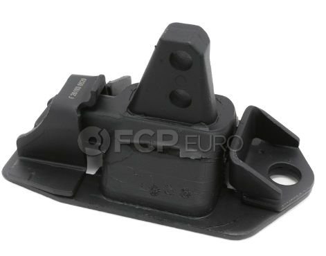

A common cause of noise/vibration that changes with engine load is the mount on the front of the engine (right side of the car) sags/tears and a metal portion of it contacts the subframe.
If that's the problem, once it's off the car you will see where the center metal part of the mount has been rubbing on the subframe.
