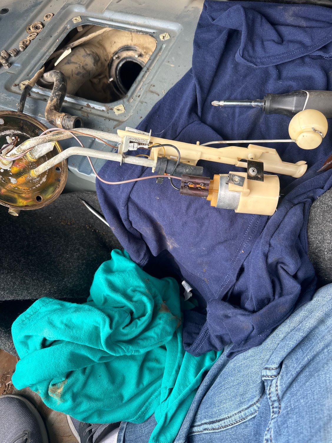

Just removed my fuel pump in tank and it doesn’t look like any of the ones I’ve seen online, will the one I ordered work? They don’t loook alike but I ordered it for my 1985 740 turbo gas
This is the pump and float from tank

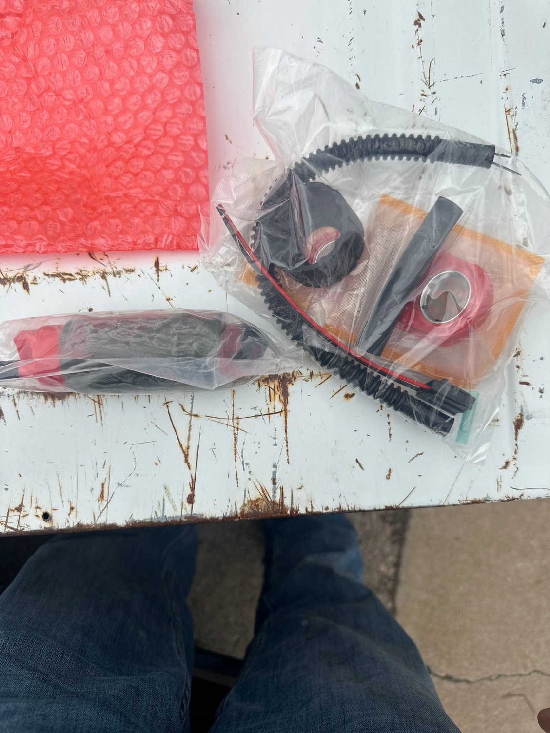

This is the pump I ordered online to fit but they don’t look anywhere near the same

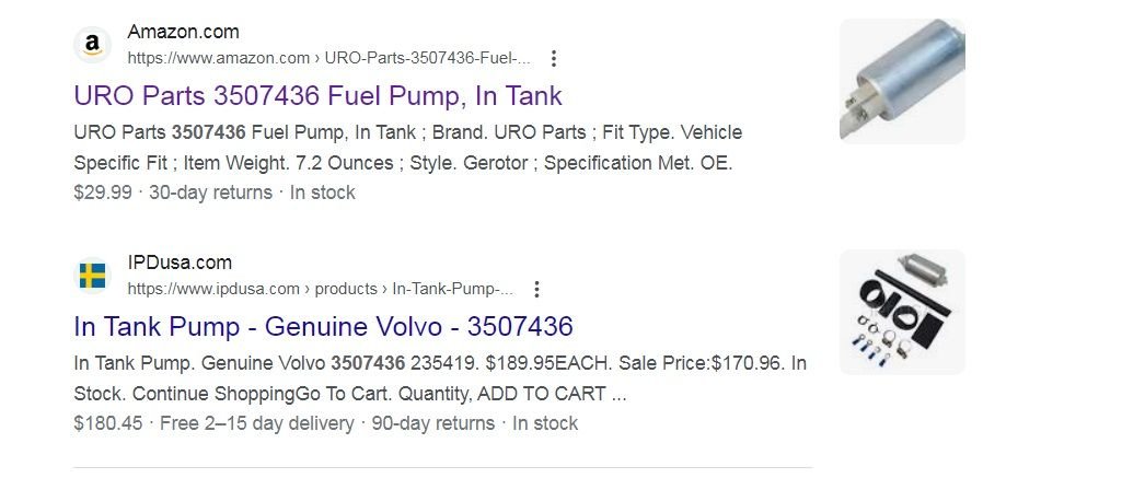

Don't know but the 3507436 pumps below will. Make sure you get a new sock filter for it. (and you do understand that is the feeder pump and the main fuel pump is under the car)

Thanks I got this aftermarket, and I do have a new one for the inline pump, thanks
