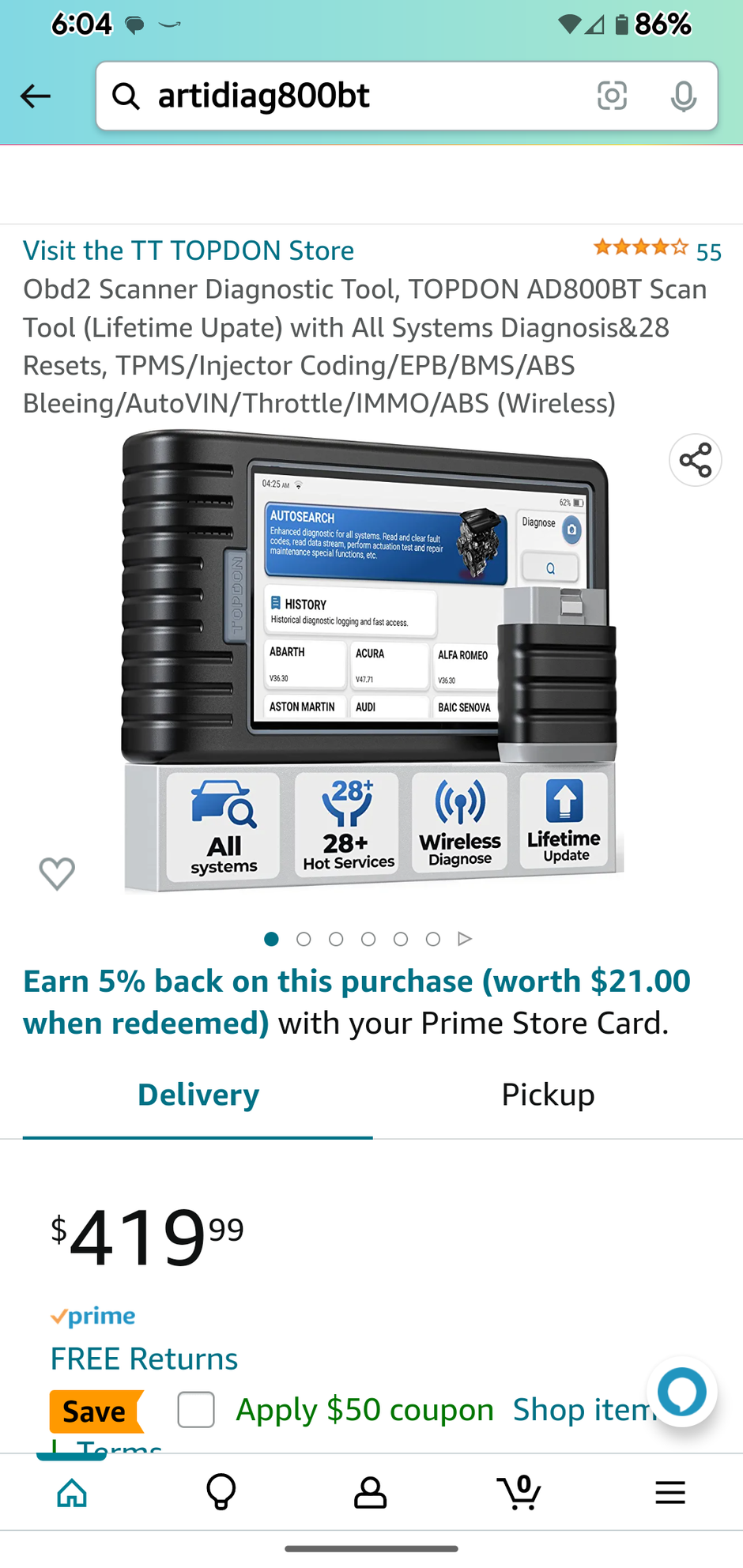

Get the the artidiag800BT, the
Get this
The PRO is only 2-years update.
