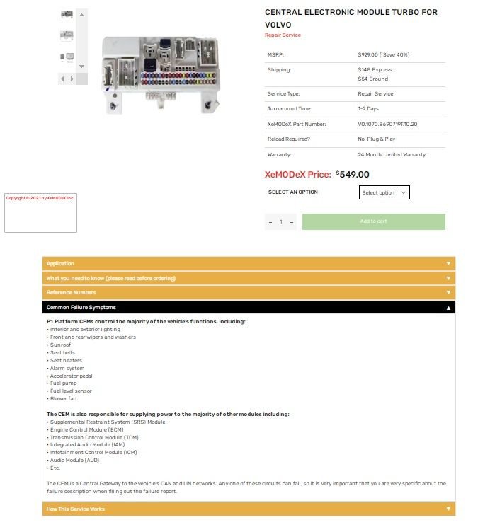

Volvo has a CEM. The central electronic module. And they can malfunction. You might want to seek out someone more familiar with Volvos - perhaps someone that uses the factory diagnostic software or equivalent. A company such as xemodex can fix those modules - but they will want any and every trouble code in that car (all the modules), best retrieved by reading the car with VIDA (the factory diagnostic software) to make sure all of the problems are solved.
