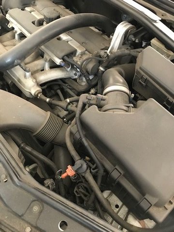

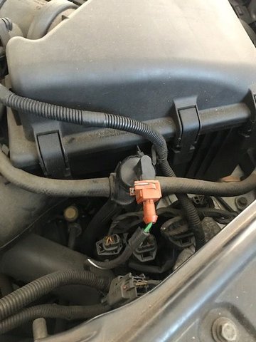

Please identify this part on '04 S80
Old Apr 6, 2021 | 04:55 PM
vheman's Avatar
Joined: Apr 2021
Default Please identify this part on '04 S80
This inline black plastic cap with the orange electrical connector. What is it?
2004 S80 2.4 Turbo
Old Apr 7, 2021 | 10:31 AM
That switch is for the vacuum pump that should come on/buzz when there is little or no vacuum in those hoses. Turn key on, (don't start car) apply foot brakes a few times, the brake booster will use up the stored vacuum and the pump should come on to supply more - it's chrome, ~3 inches in diameter and on the end of one of those vacuum lines.
Old Apr 7, 2021 | 12:25 PM
vheman's Avatar
Joined: Apr 2021
Default Thanks
Thanks for your help.
