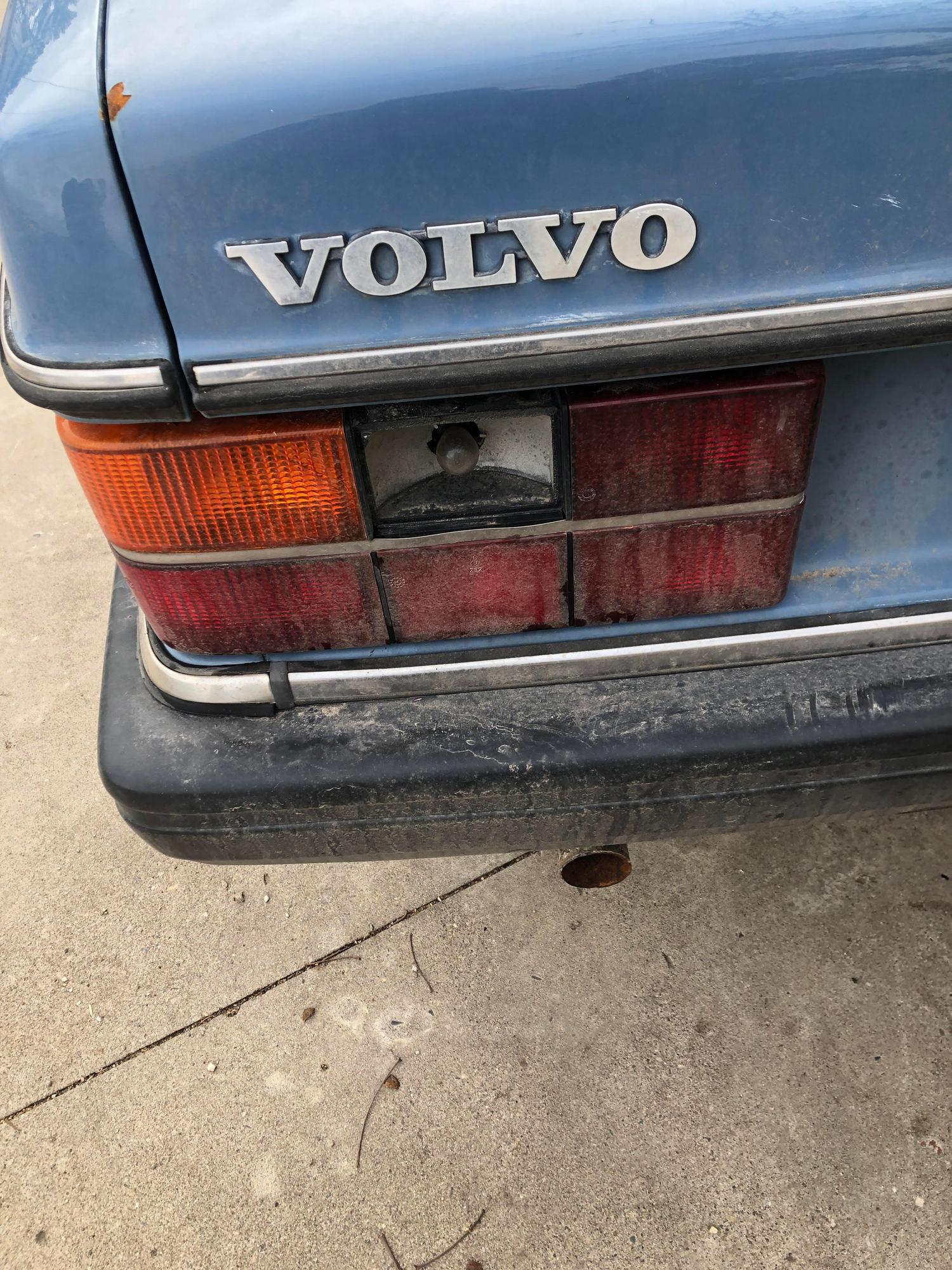

Hey all!
When I originally purchased my 1984 240 Volvo it was missing a cover for the back tail light unit (see picture). After looking online it looks like I have to buy a whole new unit just to get the cover. Does anyone know if there's a website, or is willing to sell, the single cover for this light? Any info is appreciated. Thanks!

You don't have a picture posted - but the clear reverse lenses on both the sedans and the wagons fall off. Those clear reverse lenses were the only ones that were sold by themselves. If a red or yellow fell off - you bought the whole assembly.
What lens is missing?

Oops! Here's the photo, hopefully now it shows. It's the clear lens on the assembly I need. Thanks!

part #271441 is the left, 271442 is the right. Use clear silicone to glue them in.
