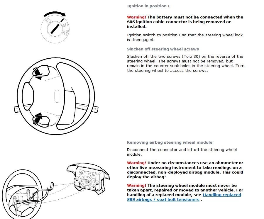

Well I'm stuck, ny steering wheel nut is loose , not me, i cannot access it. I for the life of my cannot remove the airbag. I cannot release the little wire clip that holds the airbag in place.

Vida shows that airbag held in place with 2 screws. I have removed many with the springs - but unless Vida is wrong find a torx 30 that fits.
