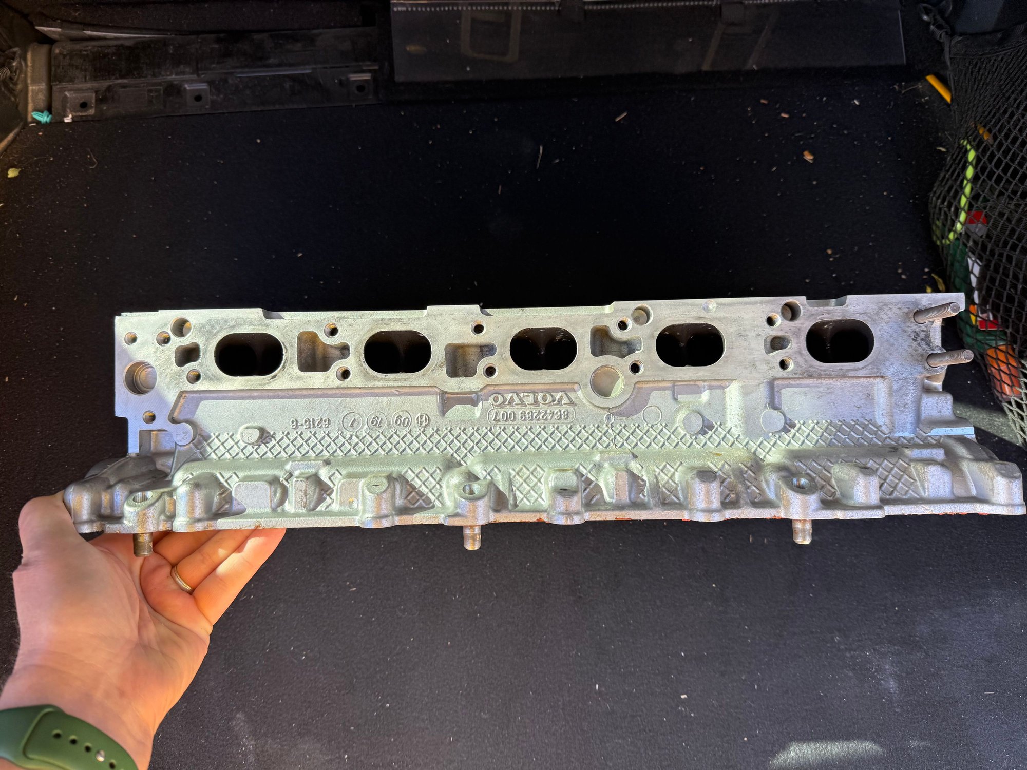

Also, on the west coast, so if anyone has any recommendations on where to get a cylinder head, please let me know.

I'd start by searching recycle yards using car-part.com. The site will also list interchange models/years. I'd also check your engine code (look for a label on the timing cover or a build plate under the hood for something like "B5244S4" then google the volvo modular engine wiki to see which years/models used that engine and read about the iterations for changes
