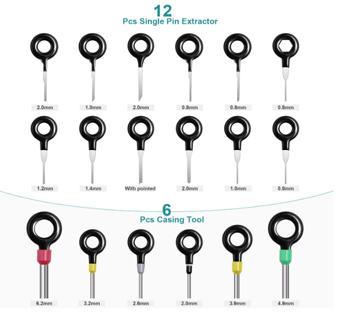

XC90 - would you know if cables in these connectors could be removed and re-inserted in different slot? the wiring in after market Android radio came wrongly wired and FL speaker is not working.
I know I will need special tools like "
Wire Terminal Removal Tool Car Electrical Wiring Crimp Connector Pin Kit" but do not know which one ( flat, thin? ) and where to insert this tool into the connector, front? rear? top? buttom?
any advice would be much appreciated after I spent 4hr trying every single thing in my house.

Flat thin on top of the connector from the wire side, it will slide out easily, do not force it. You will be pressing in a (lightly) spring loaded part of the connector that locks it into place. At least that is how I have always done it with great success.
When doing a radio, I usually get an adapter that you solder so you don't need to change the stock wiring.
