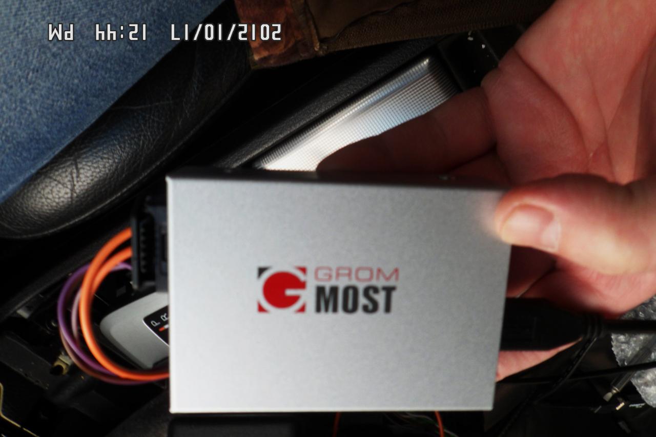

Default photos of grom unit install 2004 xc90 uk

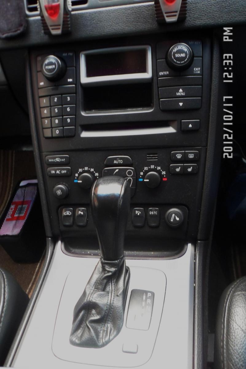

grom install start
Attached Thumbnails Xc90 any discussion-sam_0201.jpg   Xc90 any discussion-sam_0202.jpg   Xc90 any discussion-sam_0203.jpg   Xc90 any discussion-sam_0204.jpg   Xc90 any discussion-sam_0206.jpg
Old Nov 16, 2012 | 07:03 AM
gary27's Avatar
Joined: Sep 2012
Posts: 12

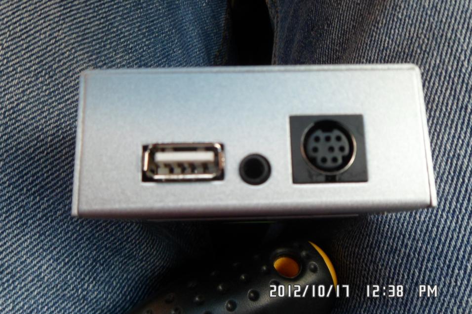

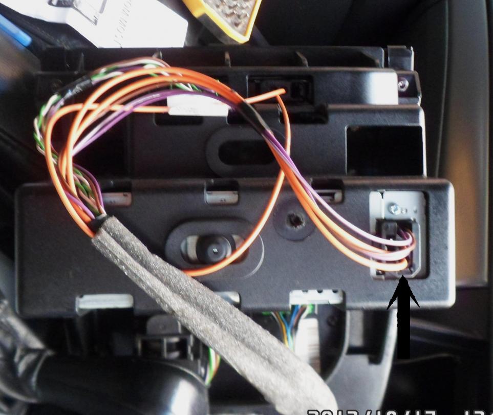

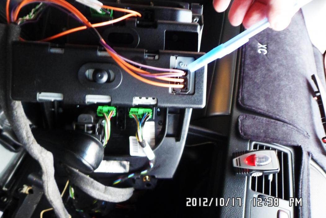

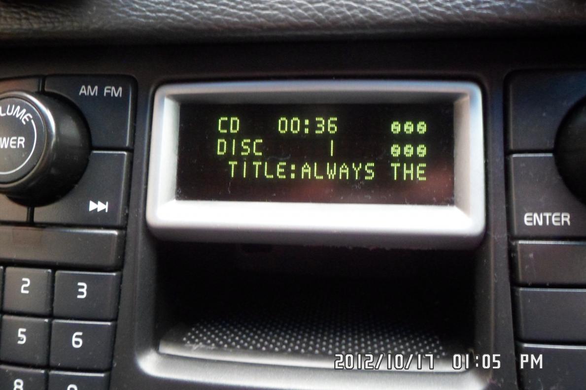

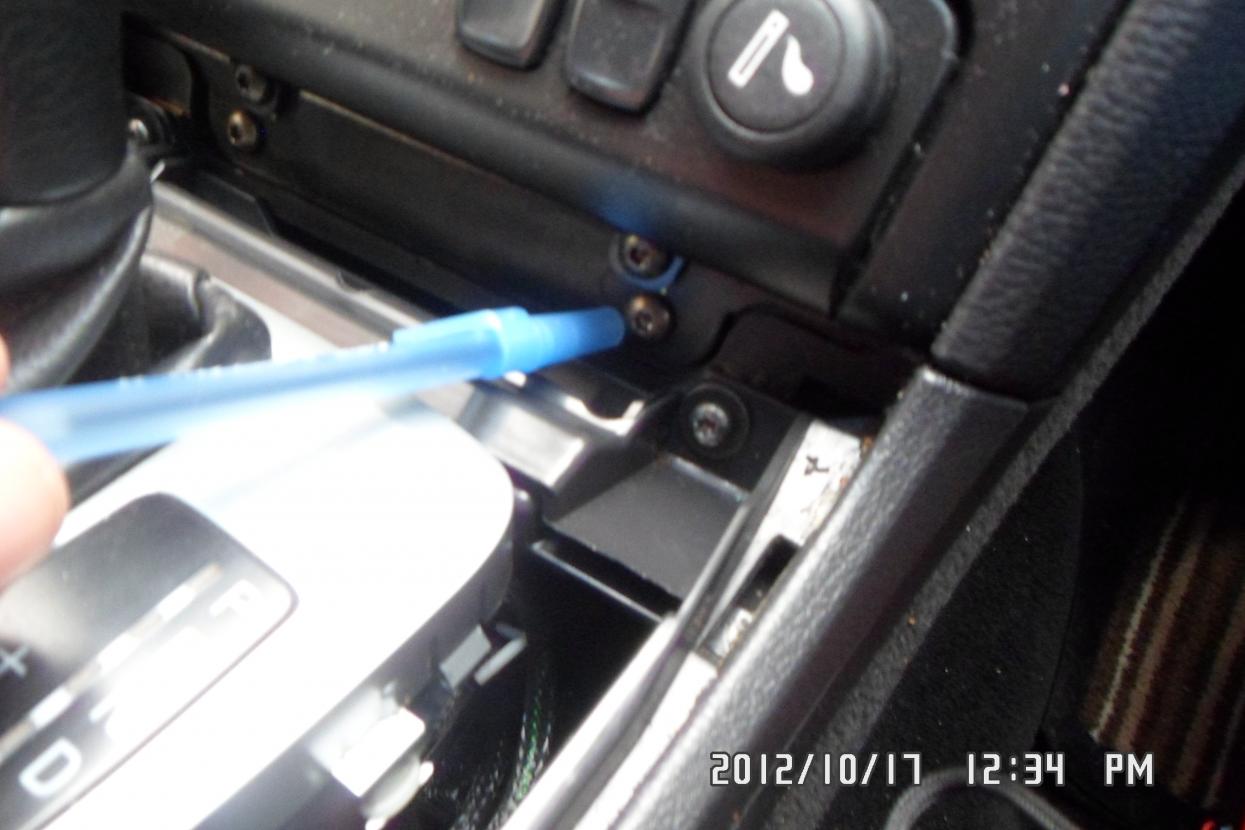

This install took me 25 minutes from start as you can see the grom unit is attatched using no more nails sticky pads or similer to the underside of the cd changer and then you can route the usb lead or headphone jack lead anywere you require
Attached Thumbnails Xc90 any discussion-sam_0207.jpg   Xc90 any discussion-sam_0208.jpg   Xc90 any discussion-sam_0209.jpg   Xc90 any discussion-sam_0210.jpg   Xc90 any discussion-sam_0211.jpg

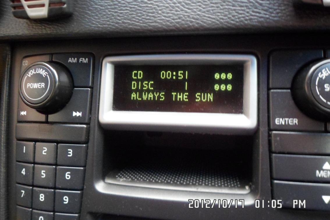

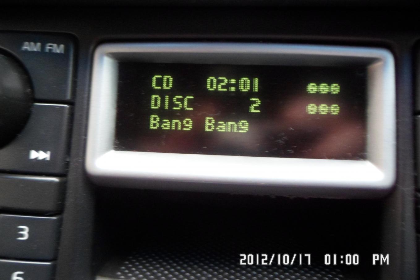

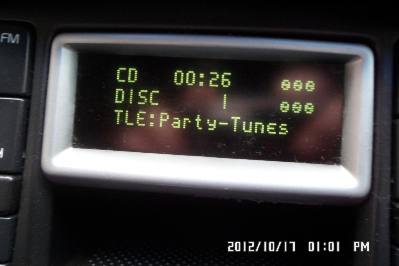

As you can see no errors i did not remove the battery terminal this is because i had the MOST security patch done from my local volvo dealer rybrook chester at the cost of £56 odd and with the £187 paid for the grom which allows me to play my music from a flash stick (Im using a 32gb) at a cost of near £243 its cheaper than replacing the full system and paying a lot of money for your cd changer to be replaced or repaired....
and the sound is bang on.......
Attached Thumbnails Xc90 any discussion-sam_0212.jpg   Xc90 any discussion-sam_0213.jpg   Xc90 any discussion-sam_0214.jpg   Xc90 any discussion-sam_0215.jpg   Xc90 any discussion-sam_0216.jpg
