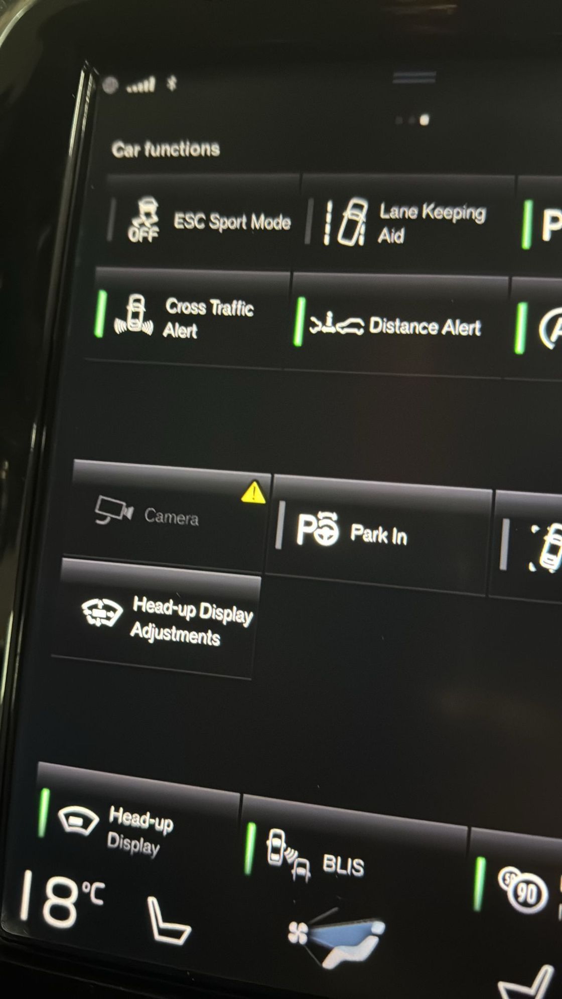

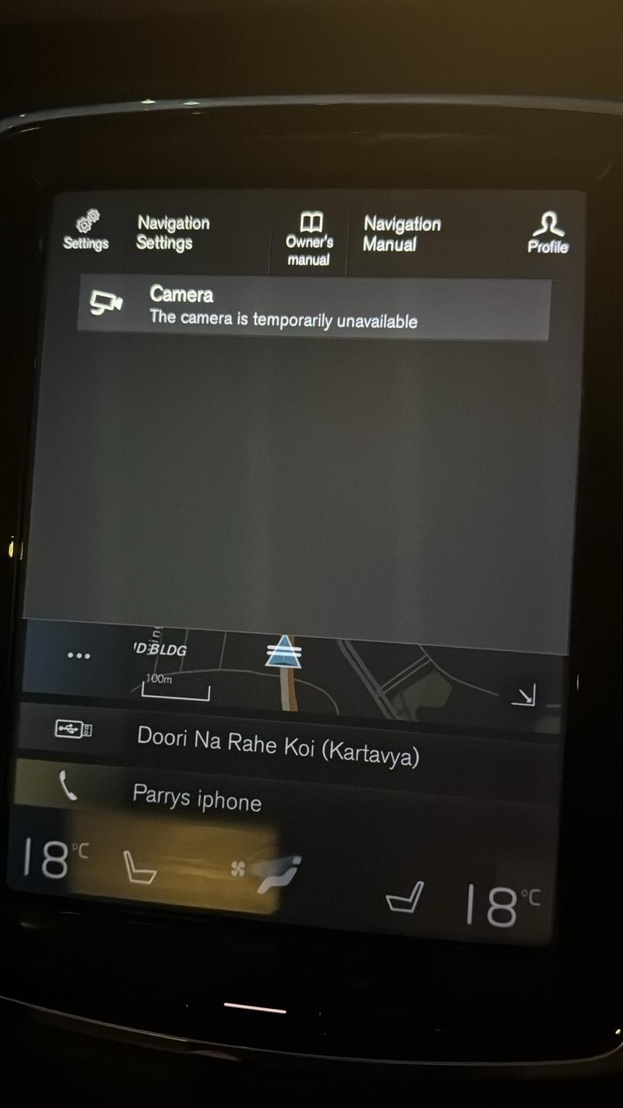

I am a owner of XC-90 T6 INSCRIPTION MODEL( 2018). My reversing camera is not coming on and it get a pop up that "the camera is temporarily unavailable.
In ignition off mode the camera tab shows camera symbol but then i see msg" camera servicing required".
I am attaching the photos of the trouble below. Does this require a software update/any hard reboot OR do i need to take it to a Volvo service station.
Appreciate any advise

Try a hard reset by holding the center console home button for about 20 seconds. If that doesn’t fix it, check for software updates through the Volvo system. I came across a similar issue mentioned in The News Portsmouth, where a faulty camera module was the cause. If the "camera servicing required" message continues, it’s likely a hardware issue with the camera or its connection, and a visit to a Volvo service center will be necessary.
