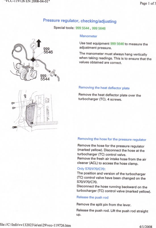

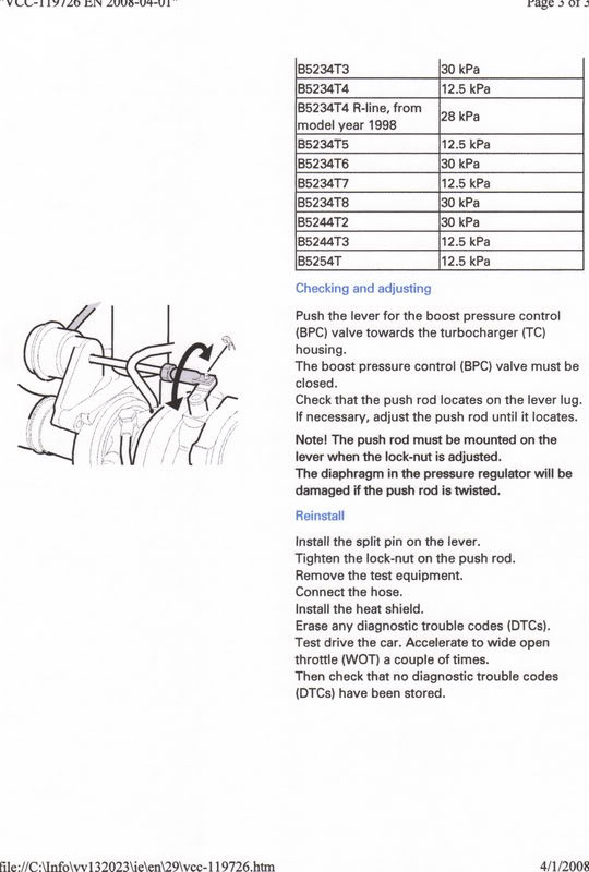

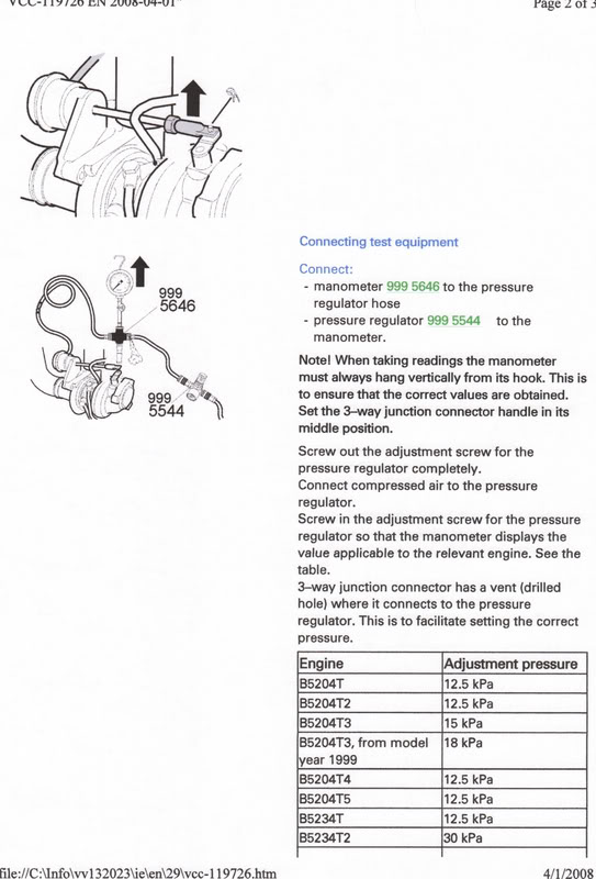

Haven't messed with a new C30 yet but how much did you move it?
Here is the Volvo presidure for setting it correctly. But it is for older cars.

ORIGINAL: hispeed
No change after reset. So i put the turbo back to "normal" and unhooked the battery. did a log and no change still 85.5%tps. so I ask, can you reset the ECU by killing power to it? or is my logger just shi$$y?
Disconnecting the battery should reset the computer but there might be a code stored in there.
That might not go away.
That will also explain the limited boost.
