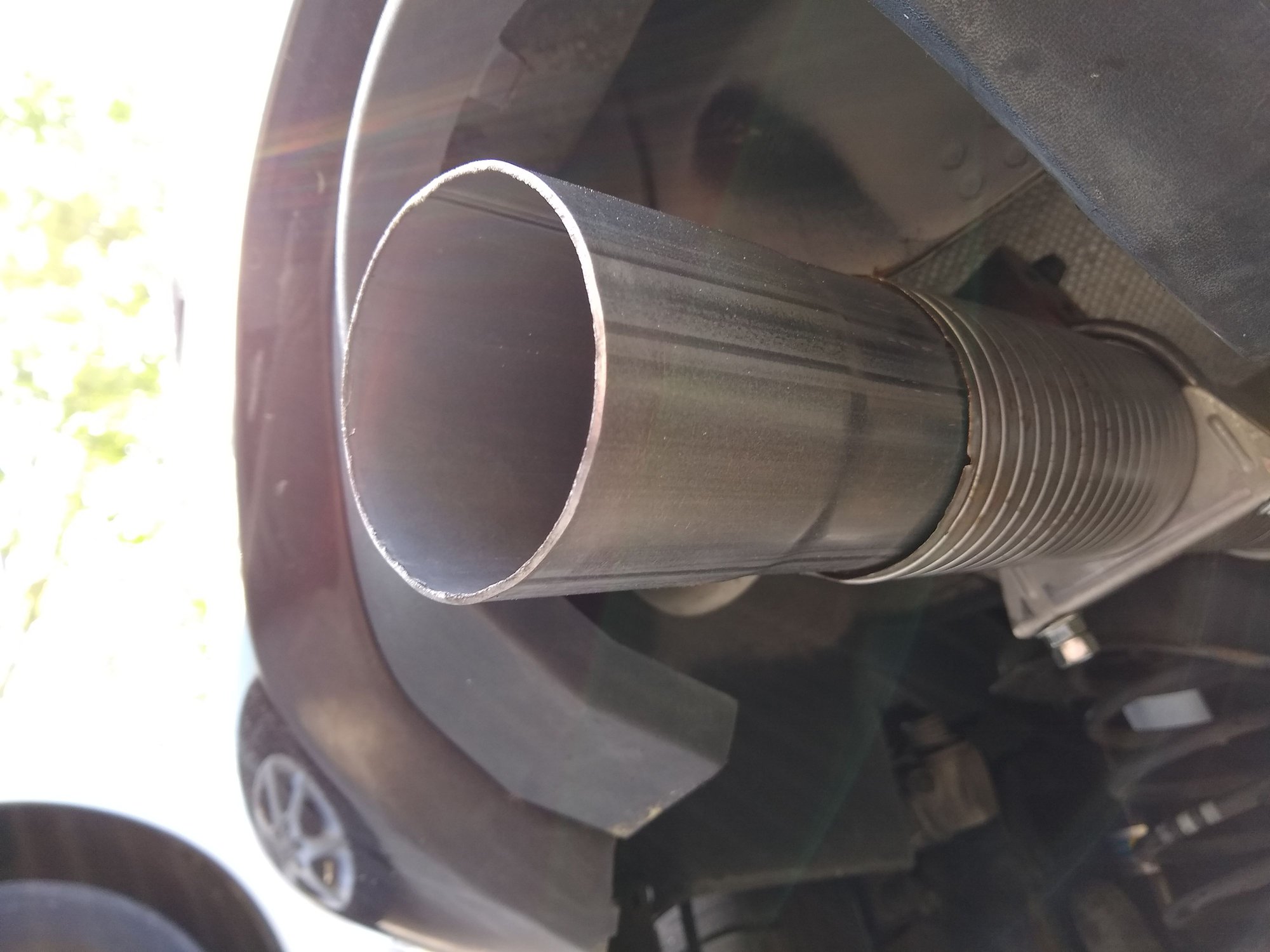

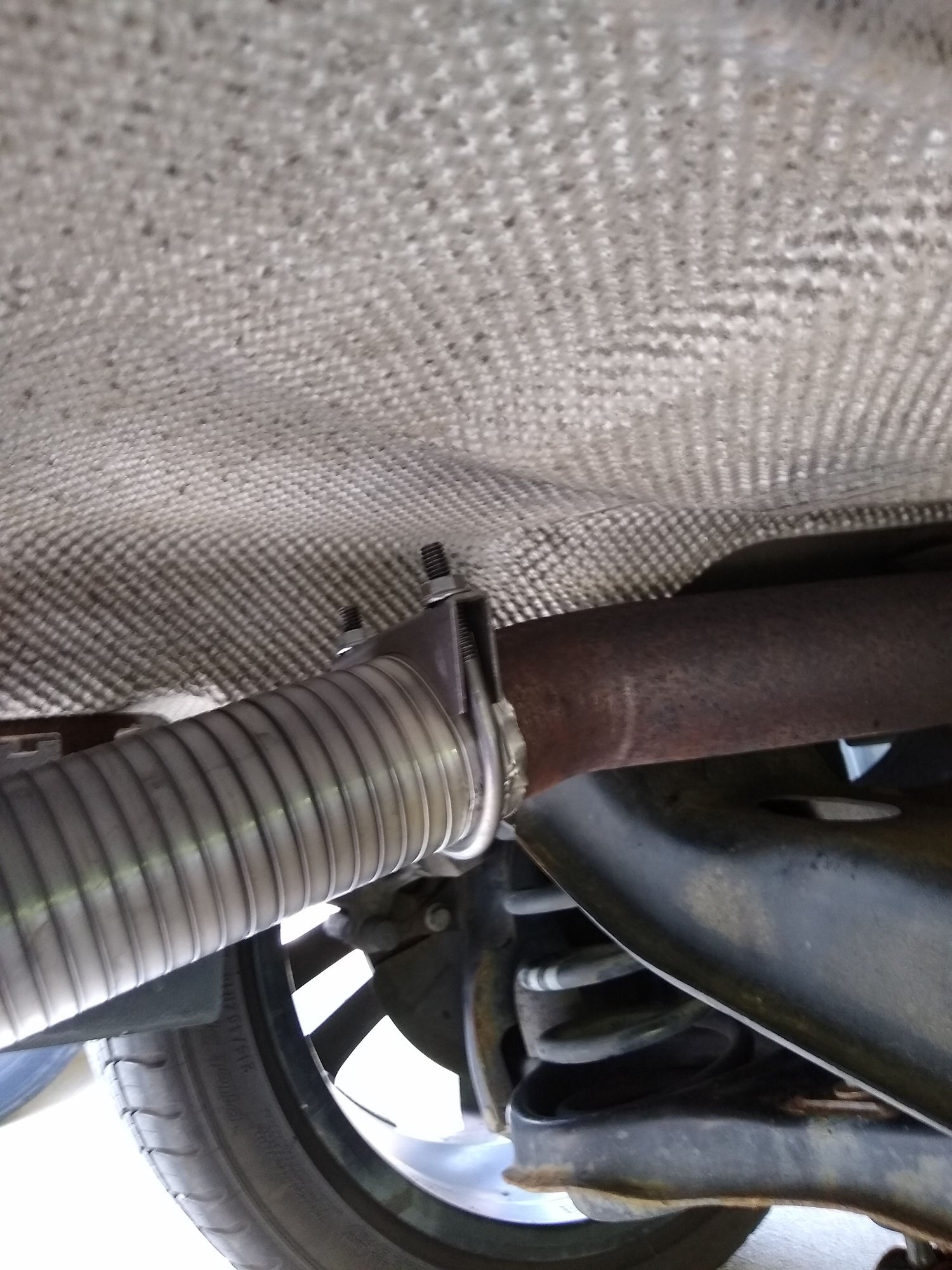

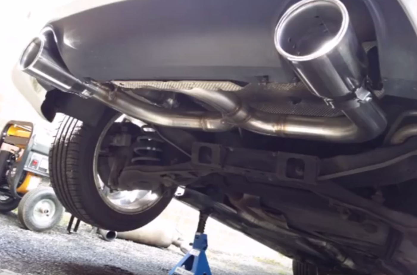

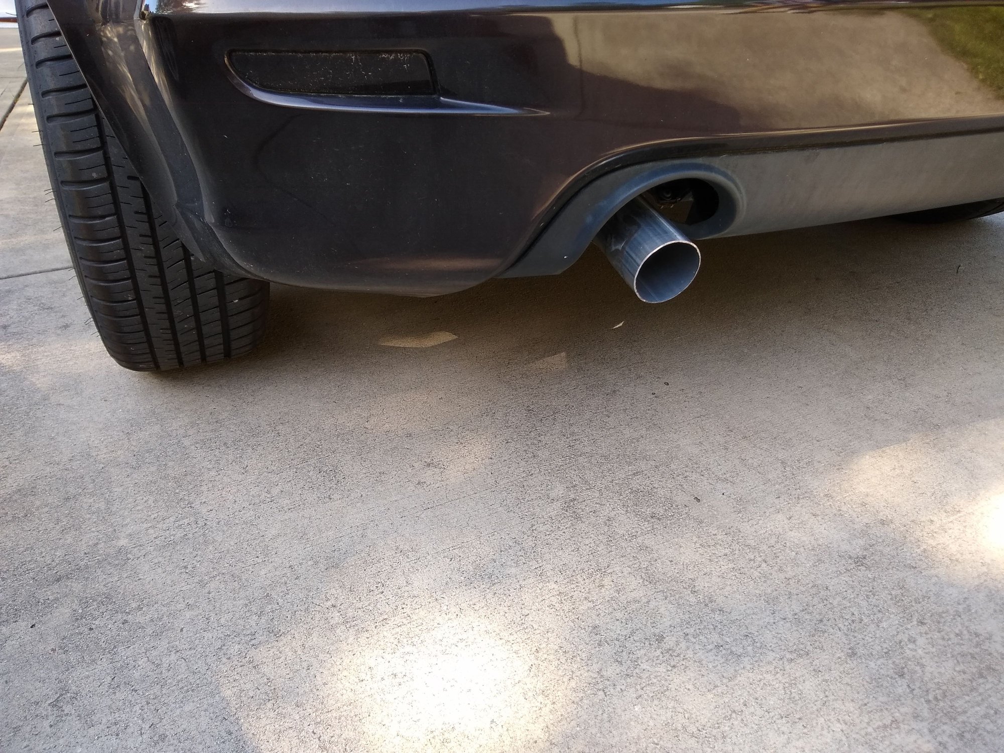

Here is the muffler delete. Went from mind numbing drone after the delete to a flex pipe, straight pipe then flex over straight pipe (inside out resonator). Learned as we went and things fell together. Very livable at all RPM's, a little burb and no rasp. Can hold us till we decide whether to buy a welder and fabricate our own dual exhaust. He was thinking we should put as flex as we can on the new system. The last photo is what we are hoping to fabricate.
