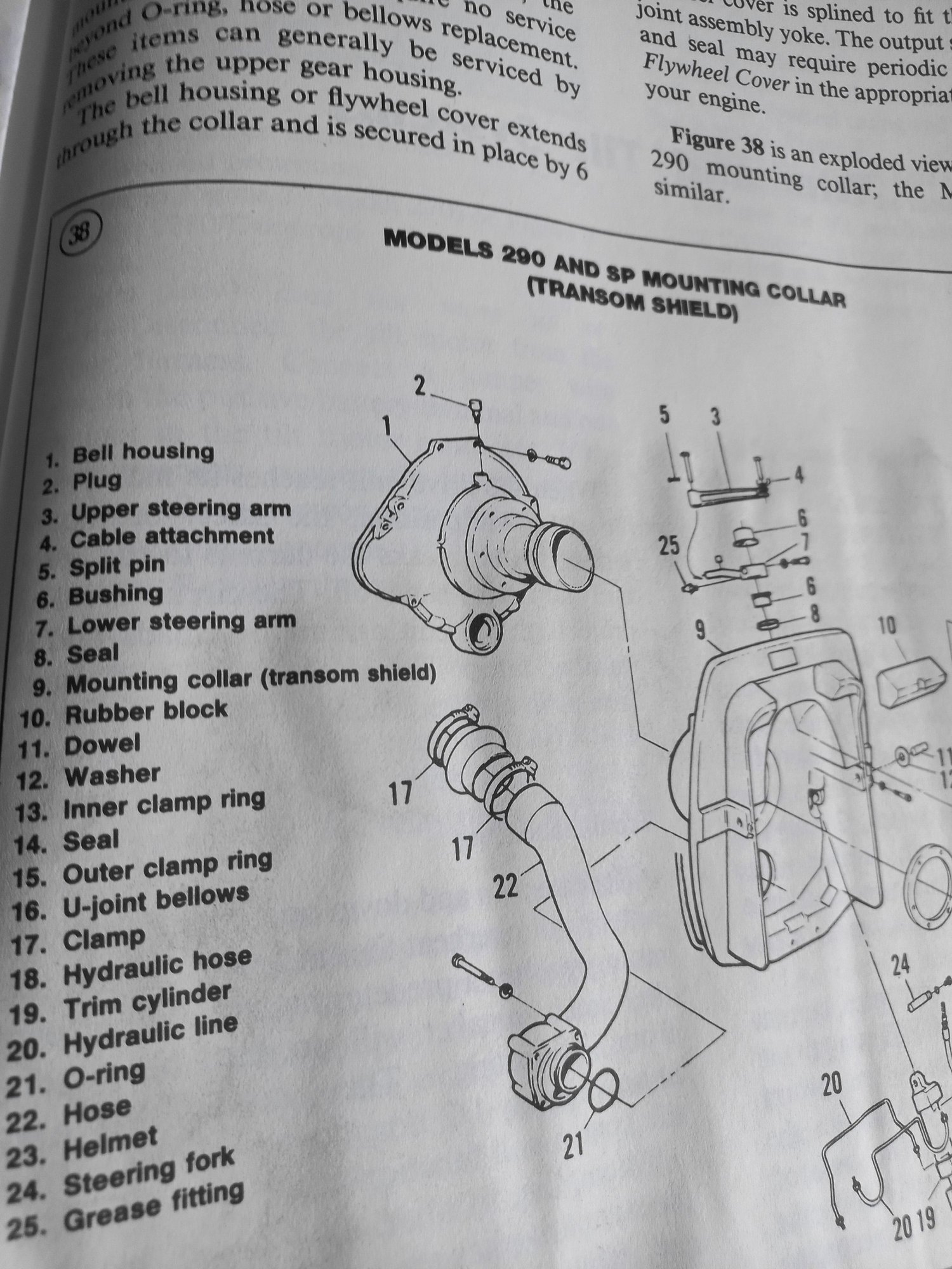

Hello, I own a Glastron with a BB115B B20 engine and a 270 heckdrive, for years I have wondered what that plug (no. 2) is for that is on the flywheel housing, but I keep forgetting to find out
Is this a breather or should oil/grease be added for lubrication of the output shaft? I have the workshop manual but can't find anything about it.
If anyone has any ideas, I'd love to hear them.
tnx
Arthur
Old May 31, 2025 | 05:52 AM
arthurk's Avatar
Joined: May 2025
Solved, made a adaptor on it and put grease in it.
