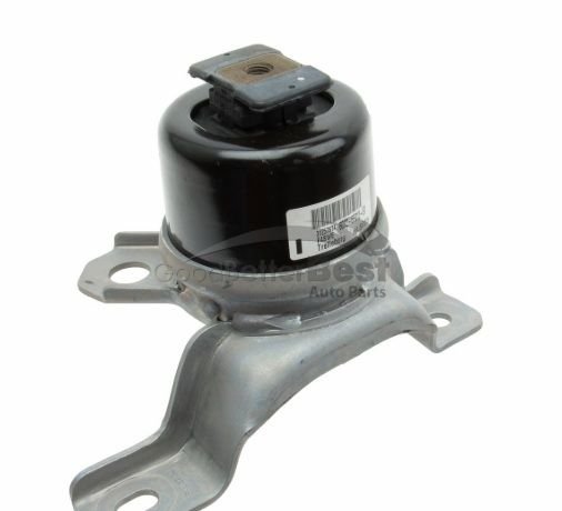

A common noise is caused by a sagging front of engine (right side) engine mount. The mount sags and the square pad hits the black part of the top of the mount. Google 31257674 for a photo of the mount - Volvo forums is not posting pictures today.
