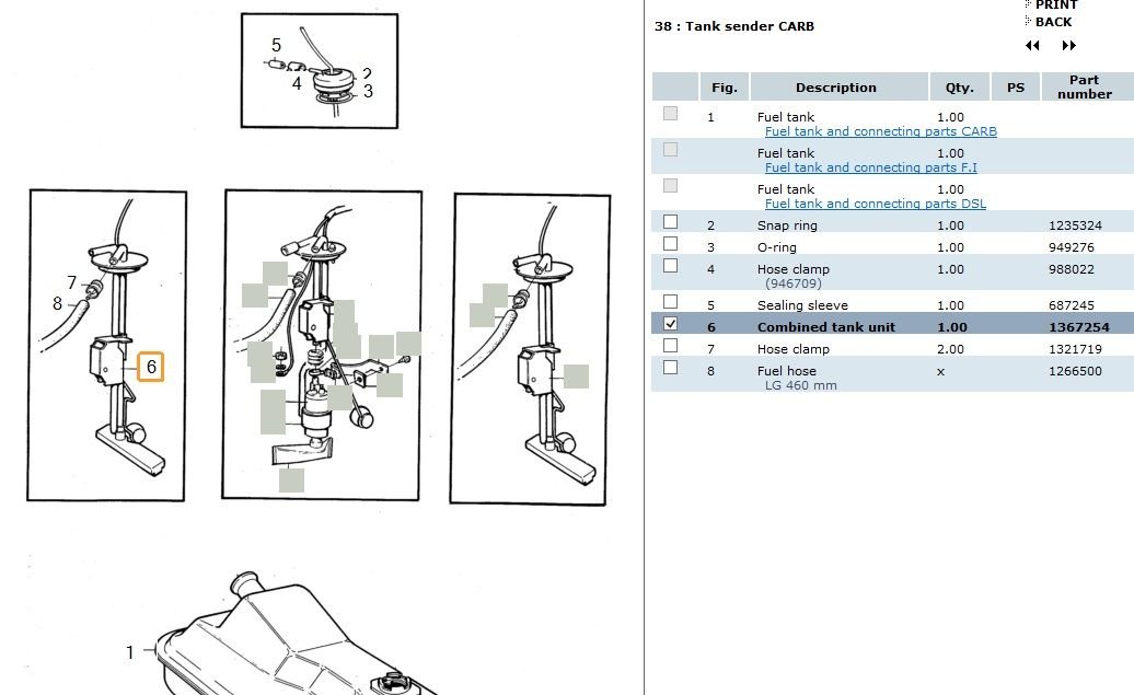

I’m gonna replace the fuel lines from the tank to the mechanical fuel pump but I’m wondering, does it also have a sender pump in the tank?
I know the fuel injected ones do but can’t find much info on the carburated models.

There's no pump in the tank on a carburetor fuel system. New fuel lines will not solve your problem unless the carb is suffering fuel starvation due to a crimped fuel line or some other unusual blockage.
Most "jerking" problems will be caused by misfires in the ignition system. Sure the fuel mixture may be off - I have never seen a Volvo with carbs after 1971 can't tell you if there is a mixture adjustment. Most carbs (other than SU style) have fixed jets and the idle mixture is the only thing adjustable mixture wise.
