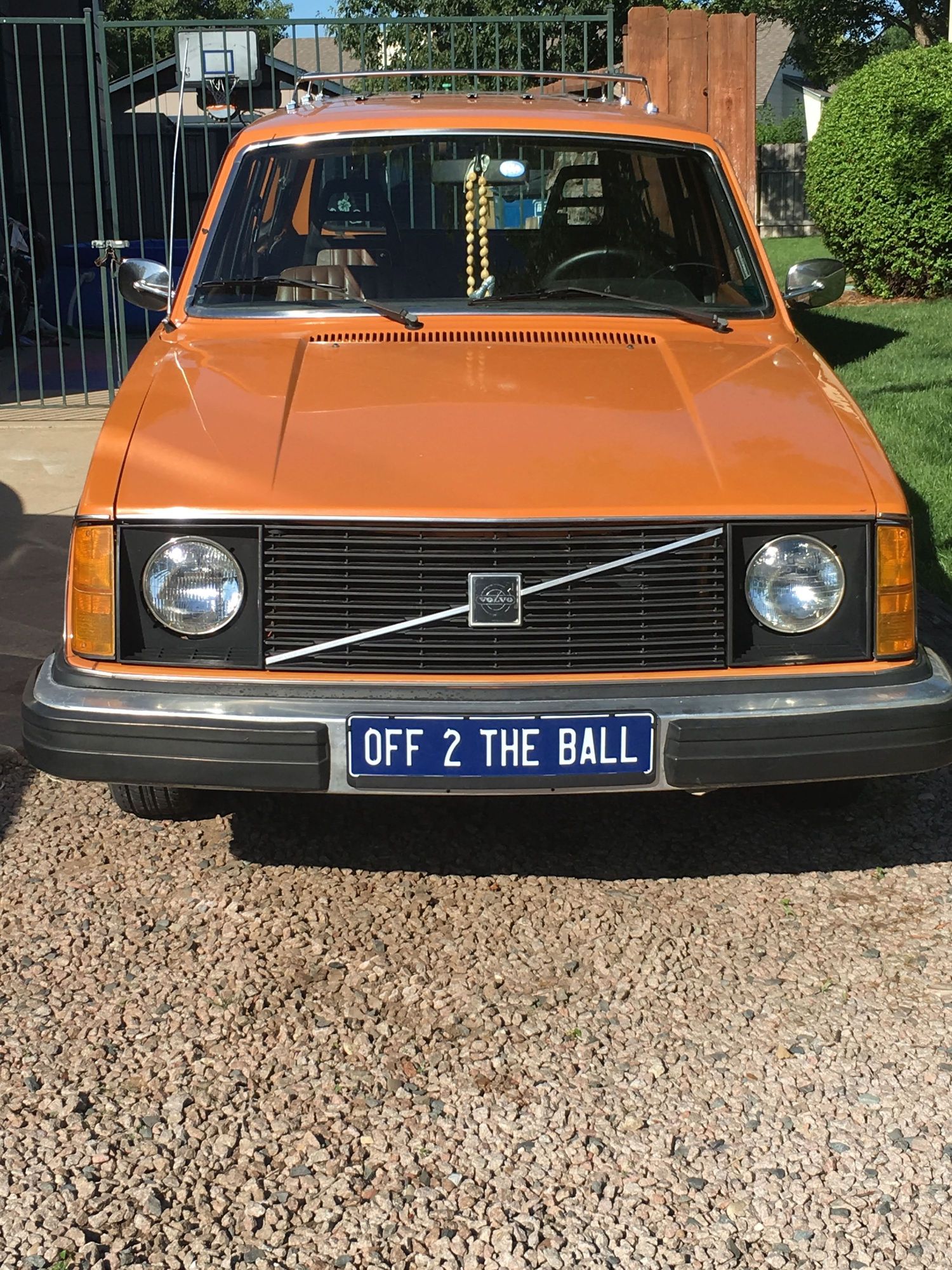

I have been fixing my grandfather's volvo he bought in 1976, so my daughter can drive it to high school.
Her sister drove it to high school and it is still a great car with a little over 100K on it.
My fuel pump is intermittent, and I'm currently having to use a jumper from the battery to the fuel pump to get it to work.
I currently have a friend looking at it who knows cars, Volvo's and wiring.
He thinks the ground to the ignition might be bad, but can't locate any schematics.
Any ideas/suggestions?
Thanks.
-Chris
'76 Volvo 240DL trying to locate wiring schematics.
