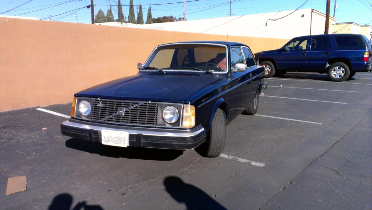

I got a new project that is my daily driver
First for me with the the K-Jet system and manual trans 4 speed "no od"!!!!!
Cost: $800 dollars
Drove home in it...60 miles
Owner had it parked for a few years...years of dog hair inside!!!!!!!! black widows too.
No major rust, two small spots only.
REPAIRS DONE:
Motor mount & tranny mount ( purrs nice and steady )
O2 sensor, plugs & wires, (made a big difference )
Oil, filter change with lucas oil stabilizer
Fuel filter, in-tank fuel pump, added Marvel Mystery Oil 4oz
Fuel relay
Battery, used alternator and belt
Antifreeze change
resistor change
differential fluid top off with gear oil mixed with oil stabilizer
manual trans fluid change(Type F trans fluid)
exhaust gasket
REPAIRS NEDED:
Cat Converter
main fuel pump
tie rod ends both sides; bushing kit
two front rotors and brake pads....
timing belt (will do tomorrow)
engine degrease and detail
smog it....and other cosmetics and nurturing.

I bought it and I will buy the Bentley Manual...I take it in this manual you get more details and pictures? I bought the car two weeks ago and wanted to post some pics. I hope more members with similar k-Jet system experience post their trouble shooting methods.
A wagon would have been super nice...! DAMN THE M45 IS LOUD....! I don't go over 65 as I feel it will blow up and a gear will end up my wazoo! I added oil stabilizer and TYPE F fluid (per Haynes manual) and took care of 40% of the noise.
