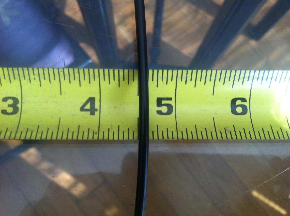

Default tube in black color
Hello all, I do not know if I should develop a new thread in this unusual case .. I knew in my in the garage, under the car a tube in black color (the pictures) I'm sure that it fell of my volvo s 70. Can anyone help me locate it in my car?
I not know where it was? I think it has to do with running a vacuum system?
this section of the forum is for volvo 240/740/940... the S/V70 cars belong elsewhere.
that said, its hard to say what that tube is from, but it /could/ be part of the gastank vent to carbon canister system, it might be a chassis drain tube, or it might be a windshield washer hose, or maybe even an engine vacuum line.
