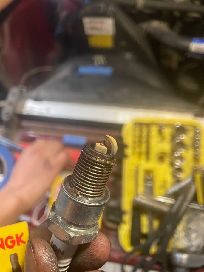

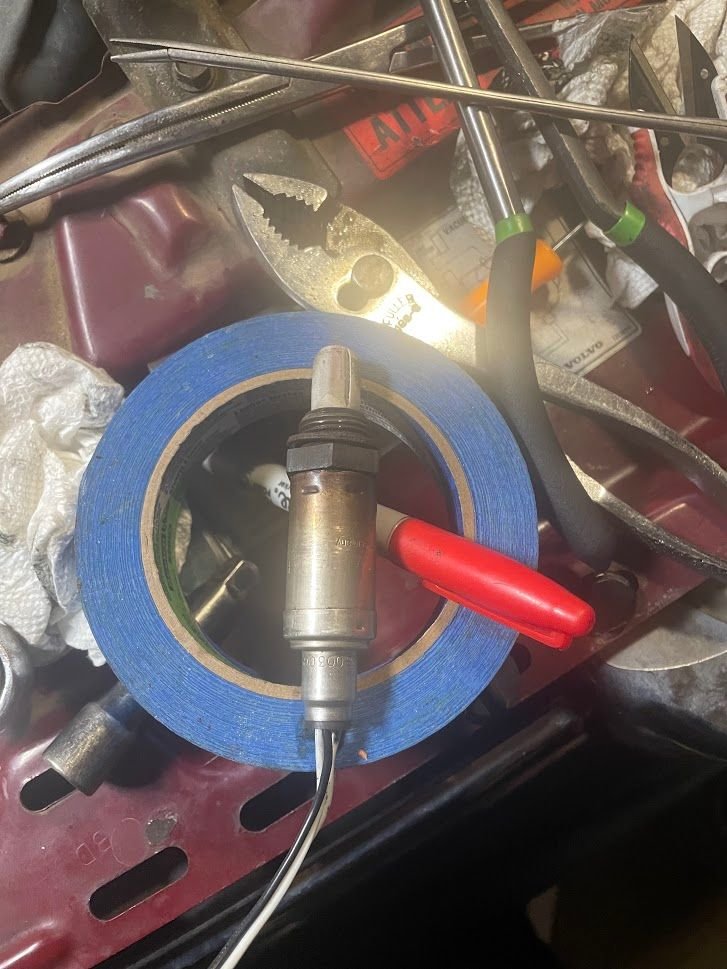

Today I headed to my friends house and had him help me with the car. Cleaned the throttle body and MAF, changed intake gasket, coolant temp sensor, O2 sensor and some vaccum lines hidden on the bottom were a little cracked, so we fixed those. The o2 sensor was like white on the tip, and the plugs looked fairly whiteish too, so the car must be running lean. However, when we started it up, it idled higher than it did before lol. We shut it off, messed with the screw and looked at some stuff, and when we went to start it back up, it wouldn't go. Fuel pump relay was clicking, but we couldn't hear the pump running. but we were getting gas at the main line up top, and managed to get the car started. It was misfiring, then fixed itself, and I drove it home ASAP lol before i shut off again. Now it won't start up again. Any idea what we may have messed up on?
