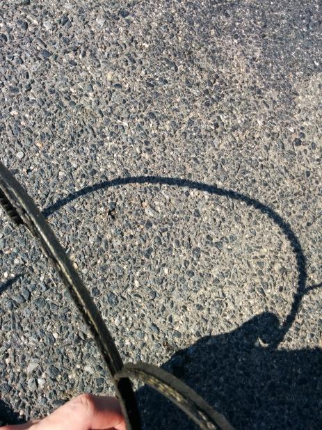

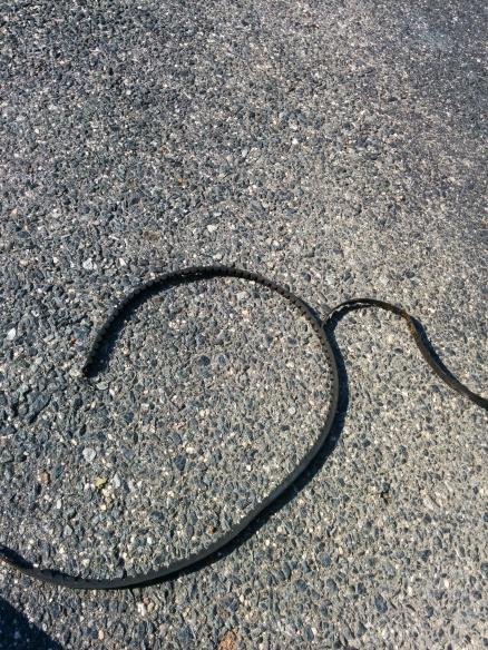

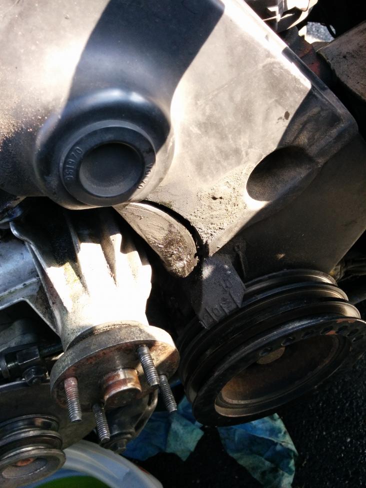

I was wondering if anyone had any idea what could've happened... I noticed my timing belt housing was damaged like a spinning thing wore into it, same diameter and area as the pulley on the water pump, and my outside belt had snapped unusually (pics attached). The water pump belt that came off was the further one from the engine... The other belts seemed fine...

what happened? the belt frayed, did the damage, then broke. probably over a period of several 1000 miles. regular visual inspections are a good thing.

depends on why it overheated, didn't you mention a coolant leak?
quality belts (I use Continentals) last a long time... IF they are properly tensioned, and everything is in line. I've had to replace the rubber bushings on my AC compressor and Alternator, and the harmonic damper (the main crankshaft pulley, which includes a rubber damper), to keep everything in a straight line as all that stuff was worn out on my 1992 with 220000 miles.

How were the bearings in the old water pump? Were they loose? A loose bearing can cause the pulley to be mis-aligned.
Years ago when we first purchased my daughter's 240, I noticed similar wear on the timing belt cover. I checked out the water pump and the bearings were tight and there were no signs of leaking. I used a straight edge on the crank pulley to check the alignment with the water pump/fan pulley. I found them to be mis-aligned by approx 1/16 of an inch. This offset was also the reason the pulley was rubbing the timing belt cover. I fashioned a couple of shims to offset the pulley and it seemed to fix the problem.
If the pulleys are mis-aligned, I would expect the belts to wear faster.

finally got around to getting off water pump...no the bearings don't seem loose, the part that attaches to the pulley seems OK. the way the gasket on the top of the water pump is damaged near the circle of damage of the timing belt cover makes me suspect the gasket has been damaged by one of the belts and then caused a leak...

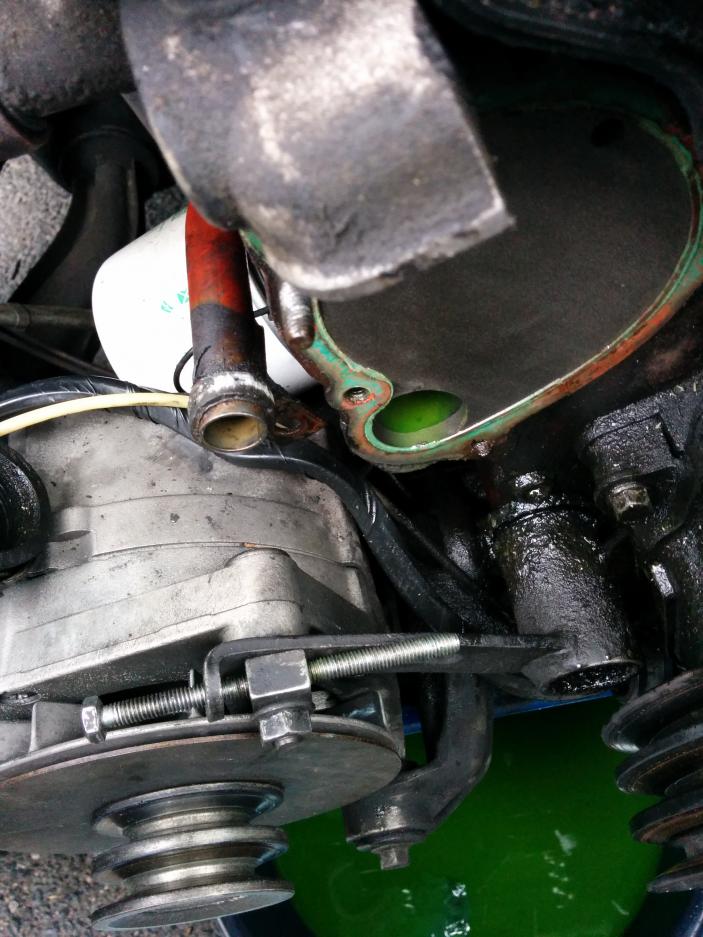

so the red metal pipe that feeds into the water pump seems to have a white wrap around it to stop it leaking (pic attached), what should i use to replace it if at all? i don't think PTFE tape would work.

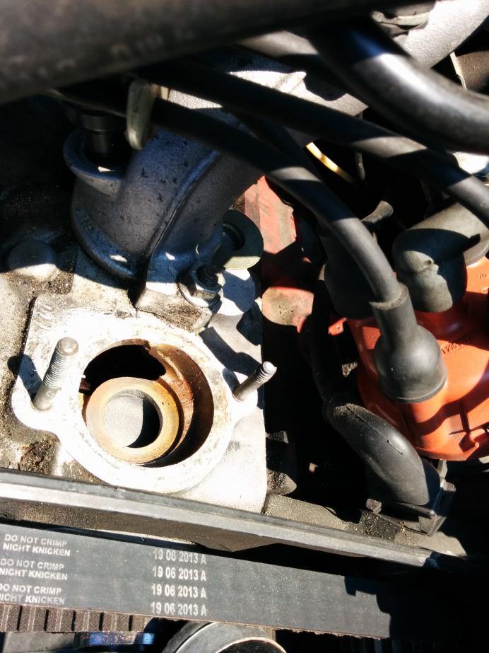

also the thermostat housing has melted gasket in it (pic attached), any tips on how to get rid of it? i'm tempted to just get a new housing...

You need a water pump gasket kit, it has all the seals. Many sources have it. May be a whole new water pump?
The t.stat gasket looks bad, somebody put the wrong sealant, may be the wrong t.stat...
Keeping the system open is no problem.
You also have/had? an oil leak probably from the cam seal by the looks of the oil around the water pump.

Great, I couldn't find torque spec for the thermostat housing nuts and snapped the stud (was going for 44ft-lb) ... Which way do I twist to get the stud out, I sprayed pb blaster on it and will let it go overnight, the other one is a little stretched out too... Should I just remove it?

You don't need to torque things like that! Just get it reasonably tight, develop a feel for it. I know it sounds a little spacey but torquing small nuts just ends badly. The stud should unscrew to the left... Leave the other one alone if it's serviceable.
