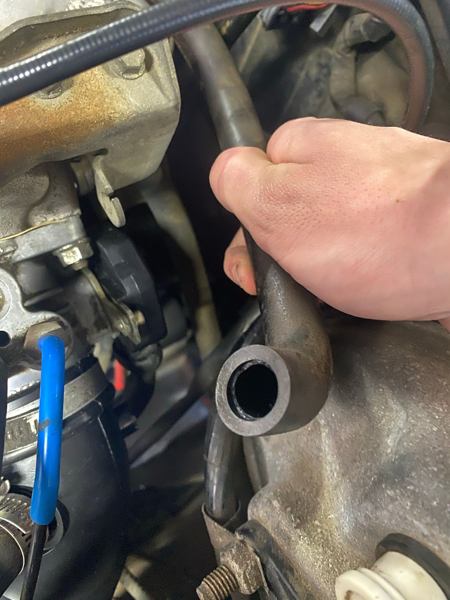

Also discovered that one of the vacuum hoses coming from the PCV system to the intake had actually broken off the nipple on the intake hose There was enough left to reattach the hose but will probably end up getting a new new one of these as well. The plastic was rather stiff and the cold temps may have made it a little more brittle.

Car was running a little rougher than the last few days so I popped the hood and noticed the hose that comes off the PCV/flame trap and connects to the accordion intake hose had actually snapped the nipple off the intake hose. Brand new too!? Getting a new one of those form iPd this week, however I have doctored it with a hose clamp for now as there was ~1/4" of the nipple remaining.
