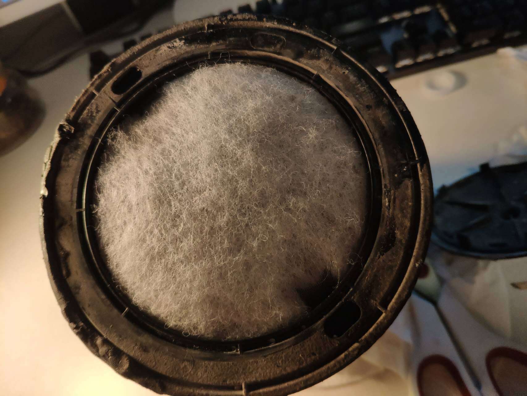

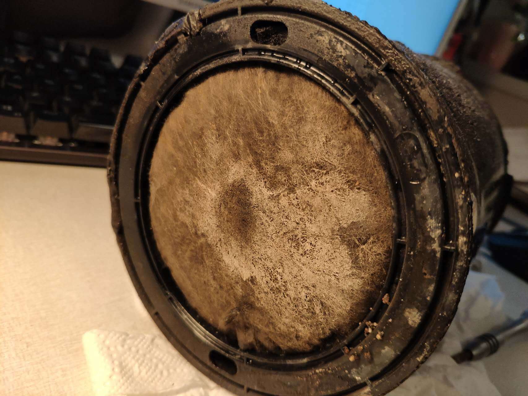

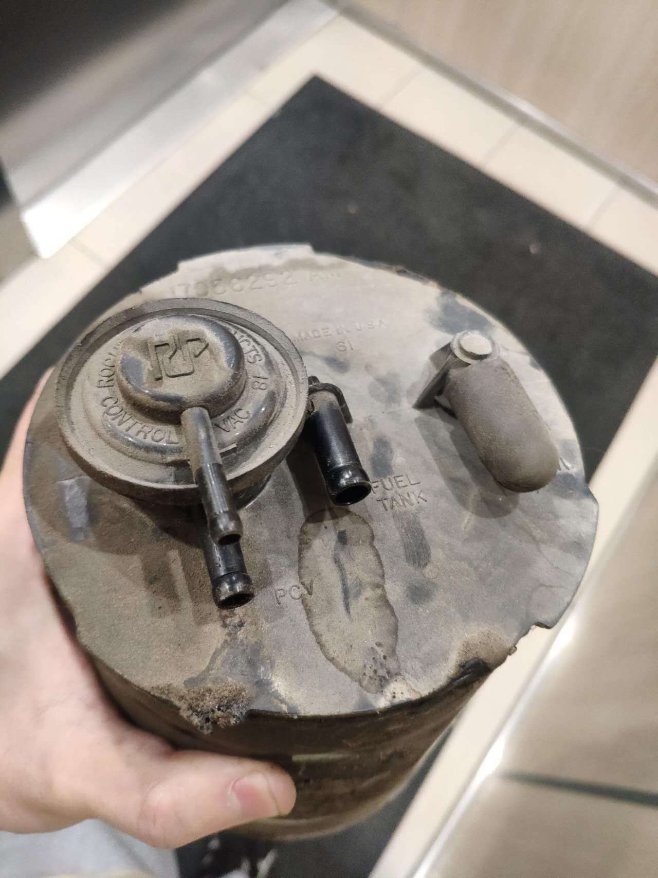

Check the vacuum valve on the canister as well, it could be stuck open. You don't have to take the canister off, if you sure the hose is fine, pull off the larger tube at the throttle, and try blow into it. When the car is off, the valve should be shut and you can not blow air through, the valve only opens when you acceralate (the small tube at the throttle opens the valve with vacuum). Also check the filter at the bottom of the canister(tho it doesn't look like to be causing your problem), clean/change it if its all dirty and pluged. Cheers!
