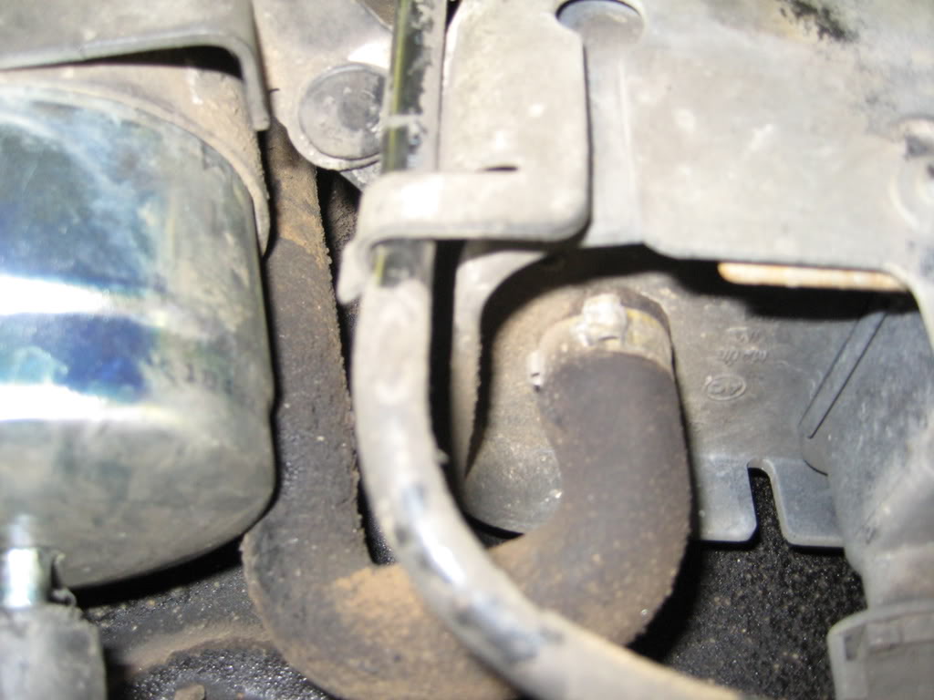

1. Locate your canister for EVAP system. My hose from canister shut valve to canister=BAD
Your canister shutoff valve is located above cansiter, or at least on my car it was.

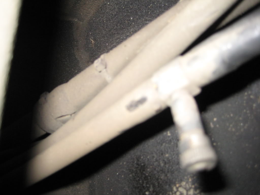

2. There is two main hoses on the EVAP canister I found, one to the shutoff valve, and one from canister to fuel cap area. The second hose also had a very nice size tear as well. Trace your hose back from the canister up behind passg side wheel, it is a factory split hose, half rubber half harden plastic types. Mine had a tear right where the two different hoses actually connect to each other.

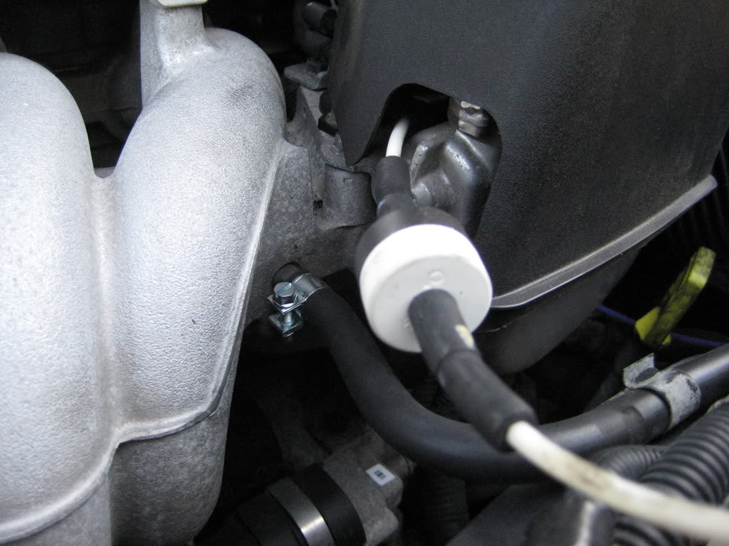

4. This is a pic of a vacuum hose right off of the upper intake plenium. This hose is part of the EVAP system as well. It connects to your Canister purge valve. Your valve is located above the radiator, drivers side, beneath the plastic cover. My hose had a very large tear at the intake side of this hose. The hose I am referring to is the one with the shiney new looking hose clamp with a flathead drive on it, not the thin whit line with the filter on it.
I hope this was informative for you. If anybody has any questions let me know. Oh yeah, do yourself a favor and get all new USA hose clamps, with mr. phillips heads on them, you will thank yourself for that later. PEACE out
