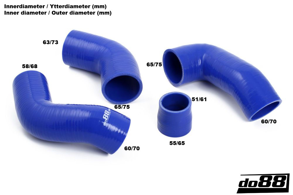

The reason I left the battery where it is, is because I was trying to use all the running gear from the 740 that I could. I was able to use the OEM radiator and intercooler from the 740 and all the oem pressure hoses. The 240 has a small radiator compared to the 740.
I was also able to use the inter cooler but had to squeeze it into the front nose piece and build a very simple supporting bracket.
Once I got the inter-cooler and radiator installed all my it would be harder to relocate the battery because my terminals, tray holder was all right there, plus on the 740T its on the passenger side so I wasn't going to try and fight it.
If you notice I even used the coolant bottle is from the 740. I was trying to use as much as I could from the 740. I was able to use all the inter-cooler piping and all oem hoses on the high pressure side by doing it the way I did. So I can order OEM hoses or even upgrade them to silicone
They are special bends and special sizes so being able to use these is a big plus.
Only hose that is not oem is the intake to the turbo, the oem hose put me into the wheel well so I had to make something longer.
