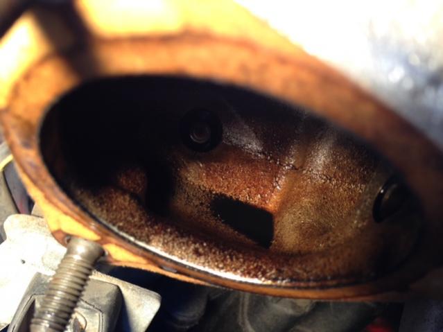

Pulled throttle body, MAF and all the hoses to the air cleaner. The throttle body is dirty which is a surprise since it was cleaned with about 1,500 miles ago. Intake manifold has what looks to be oil build up maybe from the oil separator?
Picked up a MAF from wrecking yard for $25. Has sticker on MAF that is a Germany Bosch reman. Went ahead and pickup up all the throttle body to air cleaner hoses plus the vacuum hoses from throttle body to the front canister box.
Finally got the oil separator box removed and installed a new box from IPD. This is so much easier with removing the throttle body. Old box looks super dirty and has enough grime over the Volvo label that I'm thinking it could be original.
With the intake looking dirty (see pictures). Is it worth while to remove the intake and thoroughly clean it? I was planning on replacing the fuel injector seals as another possible issue anyway. Looks like a fairly easy job and could help the drive ability. Thoughts?

the 'throttle body sensor' is simply an idle switch (and possibly a full throttle switch, depending on the year and injection system).
a junkyard MAF has a 50-50 chance of being good. only way I know to test it woudl be to swap it into a working car with compatible EFI (probably LH2.4)... if that car develops problems, thats a bad MAF. if that car continues to work fine, then its probably a good MAF.

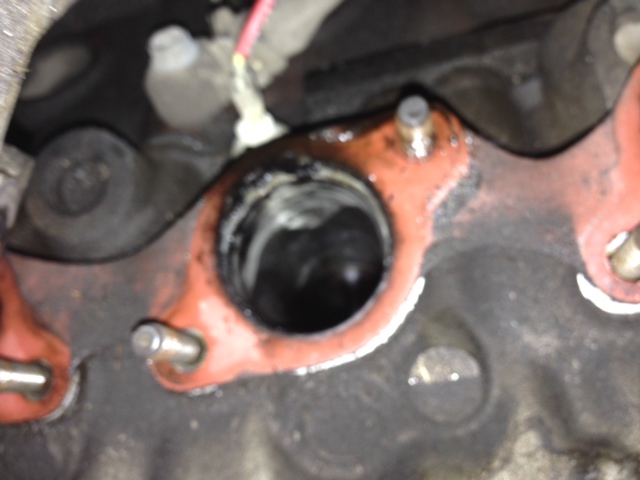

Yeah I thought a $25 MAF w/ 30 guarantee was worth a shot.
Removed the manifold tonight. Appears oil residue / deposits on two of the ports (see picture on Cyl 4). Going to clean it all out and replace the injector seals. Will install throttle body position sensor, clean throttle body, MAF, etc. then update post.

Old Aug 16, 2014 | 10:48 PM
have you done a compression test on this engine? checked the valve clearances?
i'd do that before you go much farther. if you have bum (or tight) intake valves on those ports, exhaust gasses could be blowing back the intake.
