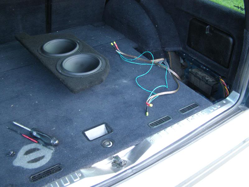

Testing is basicly done. Some fine tuning, but that is it. No noise in the lines which is good. nice clean sound. testing was done with a 12in gti.

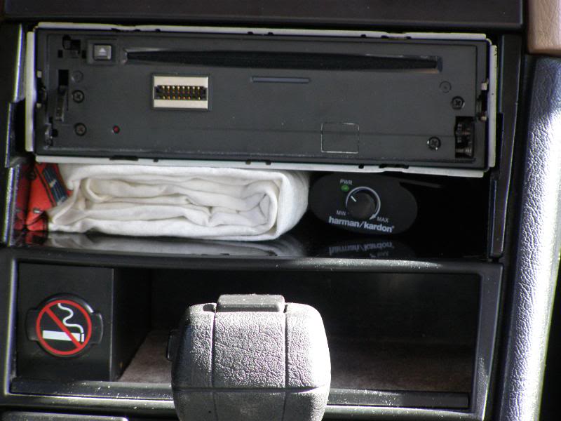

main control area (this area will get a better mount setup, but for now, it is fine):
Terrible pic, but it is alive:

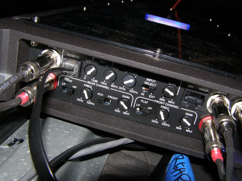

Amp controlls (sub gain is slightly turned down now):

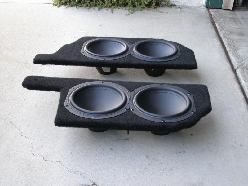

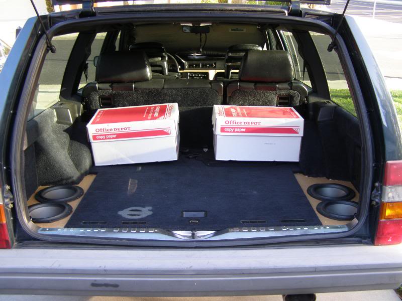

Here is what will go in:
The four 8in's should be as good as the 12in (more airflow at the same excursion), but the 8in's can't handle as much power as the 12in.

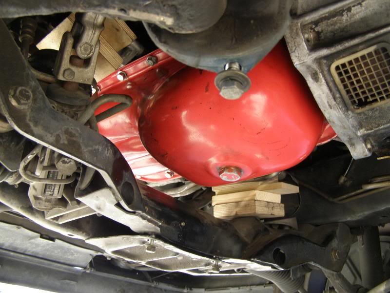

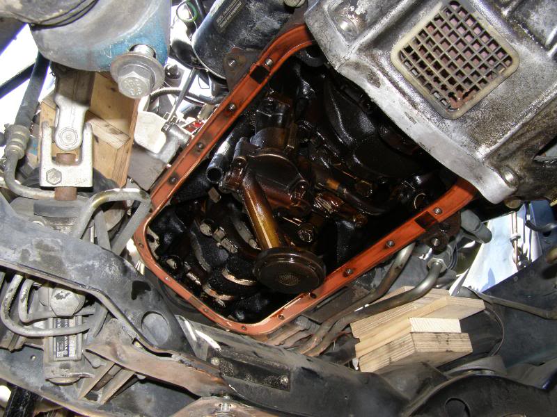

Took a break from the stereo to change the oil pan.
Pan removed:
New Pan installed:
Magnetic drain plug will go in once motor is lowered.
Not the easiest thing to remove while the engine is still in the car.
I will finish it tomorrow.

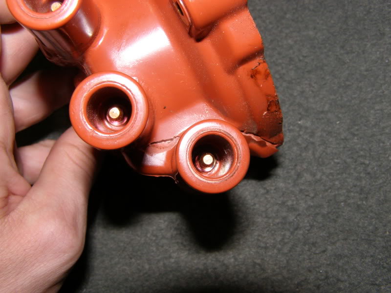

Update..
Well took the cap off, and it wasn't that dry, but not enough to do anything.
But what I did find is the connector for cylinder plug number 4 is bent, and cracked inside the cap. Probably from when we lifted the motor. time for new cap...
Old May 18, 2010 | 10:39 PM
  #207
TIPSP's Avatar
Got Boost?
Joined: May 2008
Posts: 3,473
Likes: 4

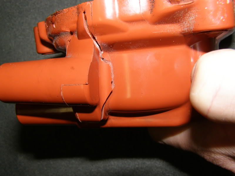

Update...
Well, it was the cap, but not because of the oil.
it seemed like it was running on 3 cylinders because it was sort of.
Forgot to remove the dizzy cap to lift the motor, and it cracked. opps.
Now... to finish the stereo.

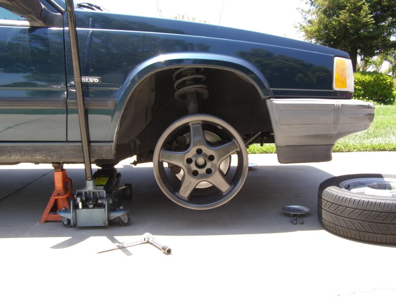

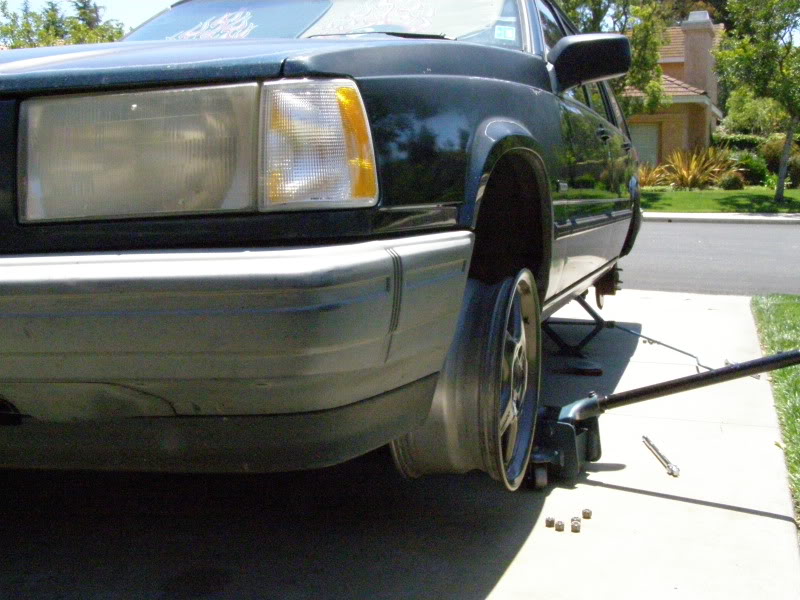

Test fitted the borbets (rims for the 240) when changing the tires.
what you think?
Not as wide as I want for the 240:
the bumpers needs some treatment an headlights need to be changed

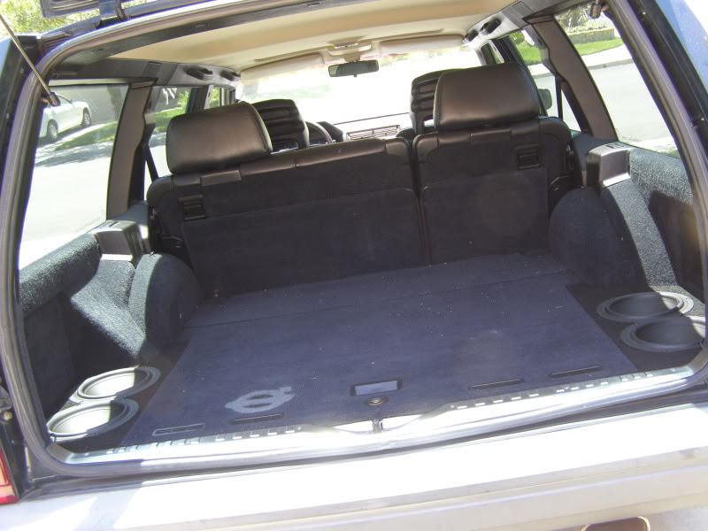

Update:
Finally put carpet on the panels and painted the cones black.
The carpet is different, but it it's okay.
Need to fiberglass the insides, then seal the holes which vent into the main floor cargo area. then finish sealing the door panels, and quiet some of the rattles in the rear. Then make the grill to cover the speakers to protect/hide them.

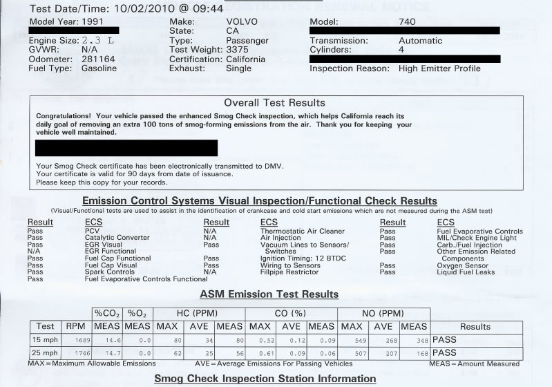

Smogged the 745T on saturday. Passed with the 3" turboback and highflow cat, chips...etc. I put the stock airbox (basicly brand new filter) back in for the visual part, but my guy is pretty cool and wouldn't have cared. burns fairly clean, just at the max of the HC's.
I dont remember if the weight is tested with or without the tech, but 3375lbs isn't bad for a 91 wagon... it is about the same as an 05 evo, and lighter than the newer ones
