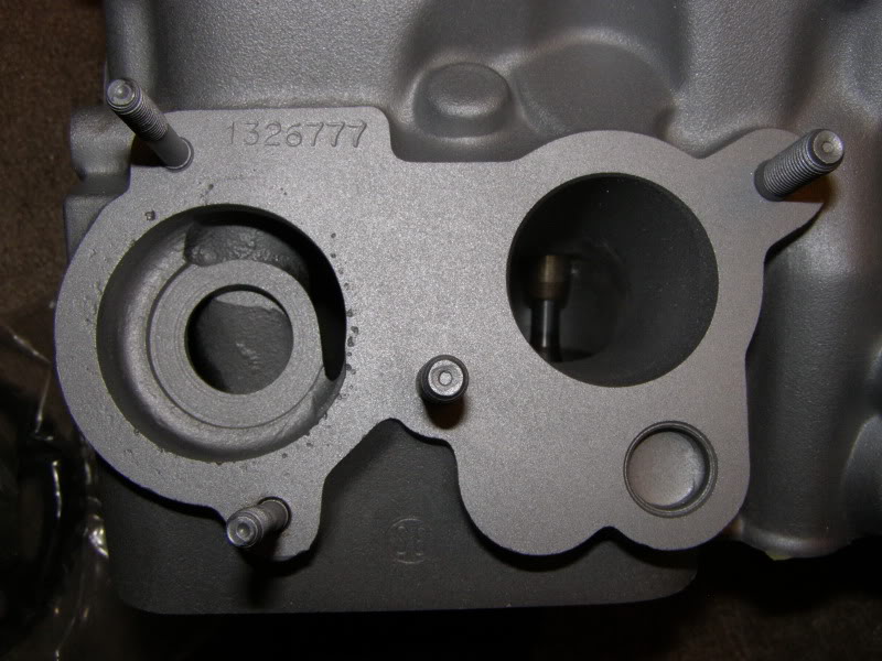

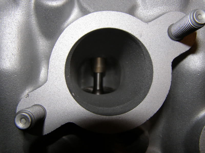

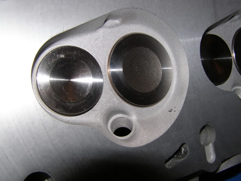

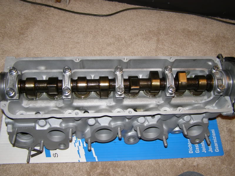

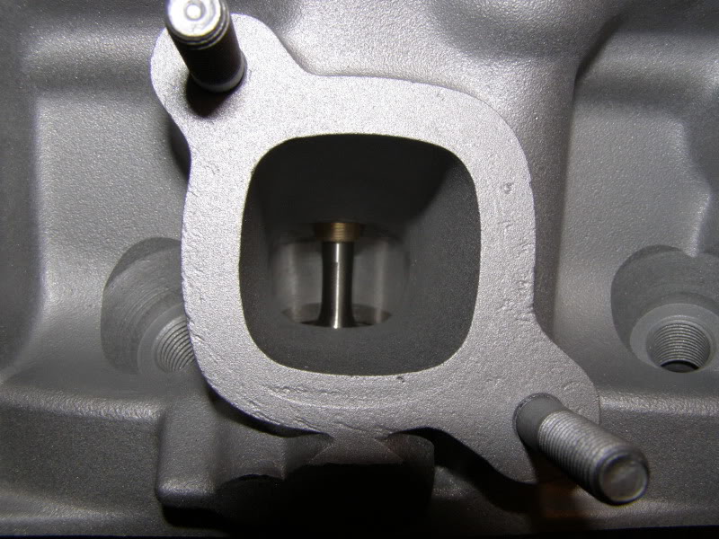

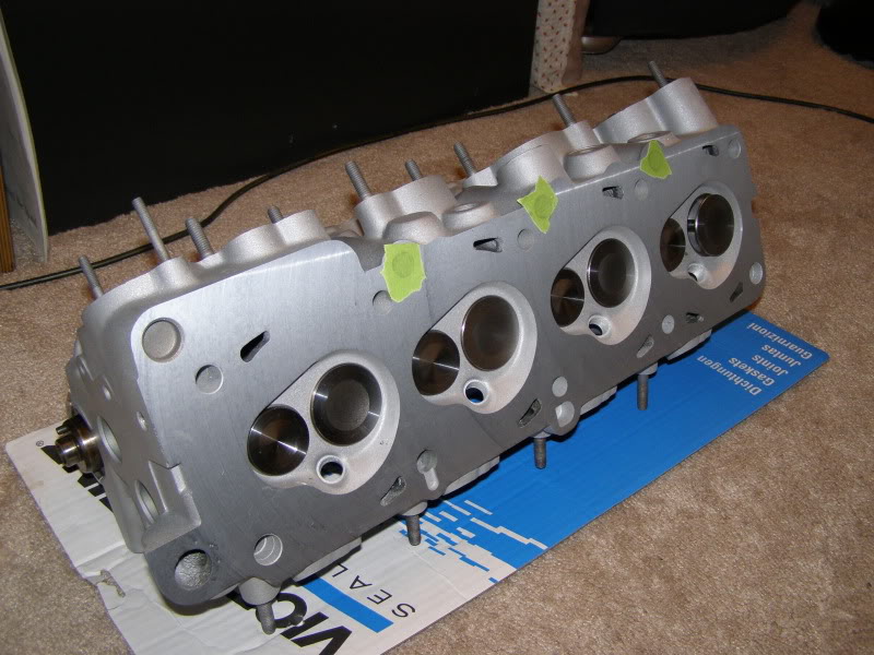

Well, we got the head in today..
CAn't wait to get the car running.

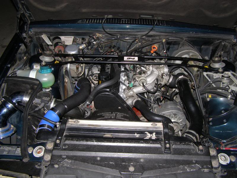

Thumbs up Car Runs, and is doing fairly well!
Only ran into one problem, though, it really isn't an issue. The new head had a thread hole under the fourth runner for some sensor or something. our old head didn't, so we had to pulg it. NP...
Anyways, The whole processess went very great. Finished it monday, and the car started up first try on the first crank! It made some funny nosie and some high pitched whinning during the first start/idle phase, almost has a knocking sound, but I sware the knocking sound has been there since they got the car. All the other whinning nosies are gone. Drove the car on a 90 miles trip 1 hour after the first start up, and did fantastic!
We checked compression before the first start up, and got some disappointing numbers (#1 120, #2 = 105, #3 = 80, #4 = 115).
We will check after the head is broken in. Those numbers better improve, or we'll be pissed!
Still breaking in the new head, boost was turned done to ~10psi, and we are trying not to load the motor so it will only hit 0psi max for now, keeping revs below 3,200rpms with little throttle.

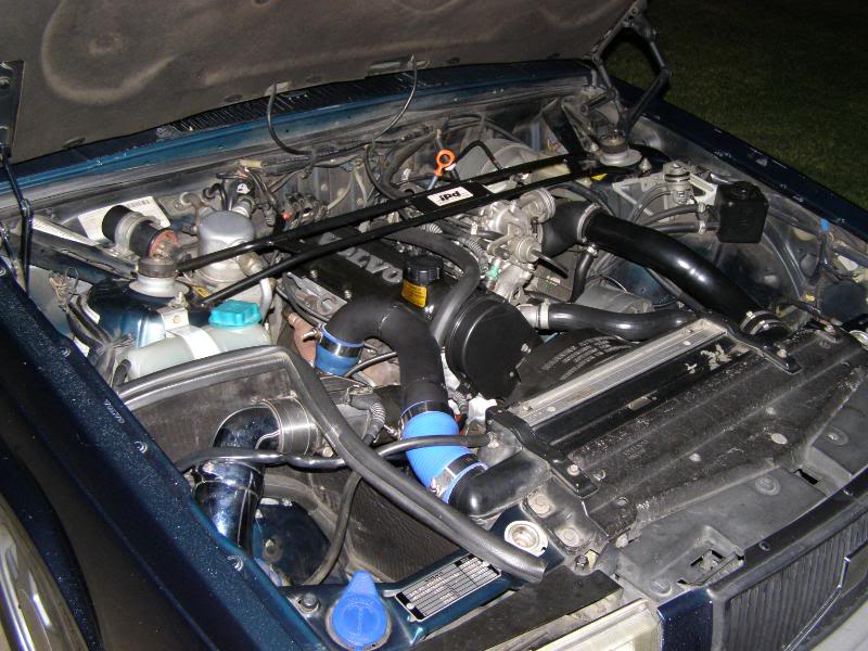

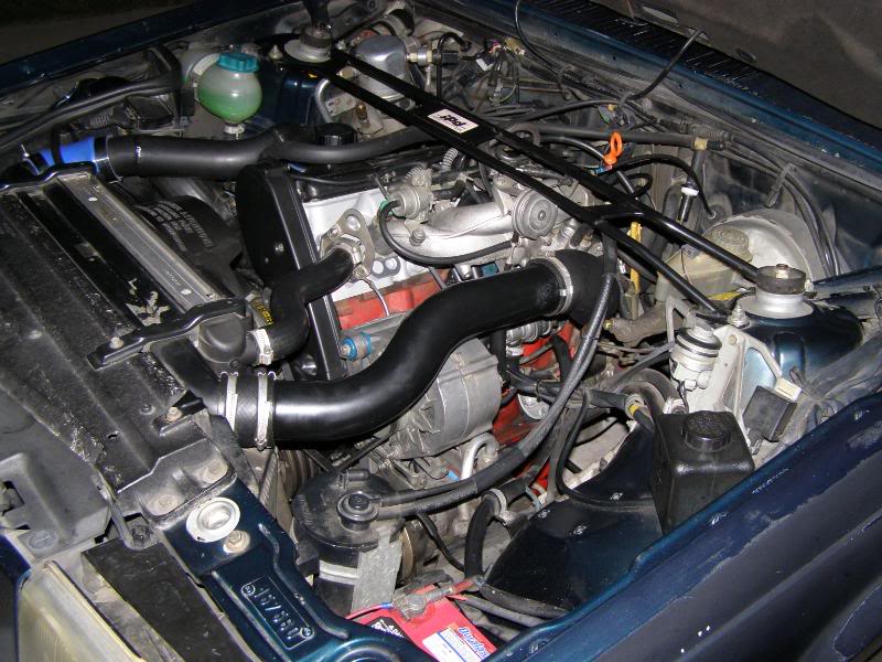

Crappy pics from tonight:
I really wish it has a new cam now...
And the turbo is going to get replaced sometime next year (found some small cracks, but it still boost great).
Now it is time to start the 244T projects.

For the next time you build a motor make sure to coat everything in assembly lube especially under the bearing caps. Just pouring oil over the cam shaft isn't going to allow oil to get under the caps and protect that area. Also with the plugs out turn the motor with the starter (or if you can access the drive shaft on the oil pump spin it with a drill.) for about 30 seconds. Just hand spinning it doesn't pump the oil up there. And there is quite a bit of oil to pump up to get it to the head.
