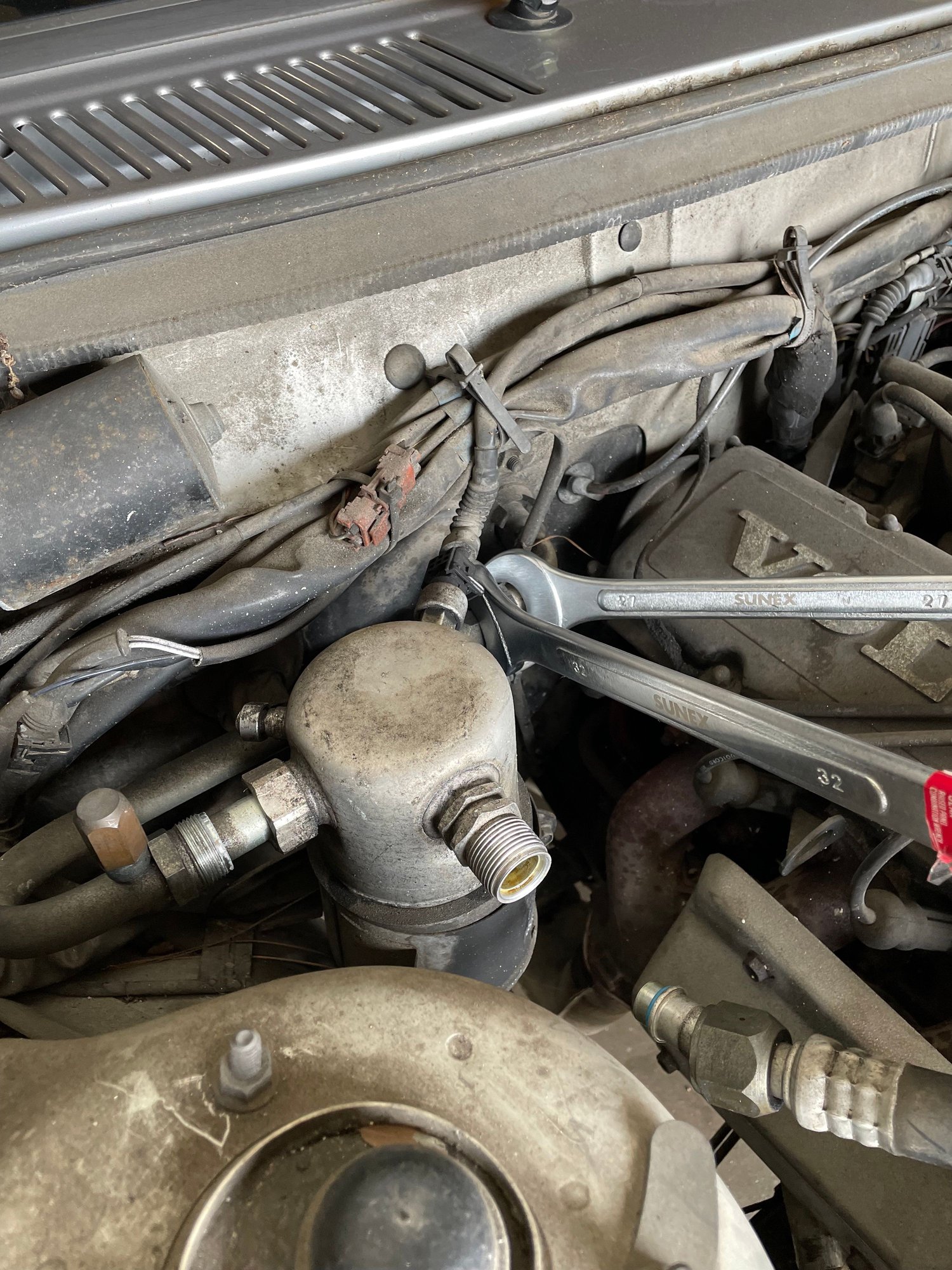

I guess that's it for getting the compressor out. I'll go ahead and detail the steps I took to get the AC working too. Once the compressor was out, I turned to the hose connections. Before tackling them I used Kroil penetrant for a few days to help loosen any corrosion. I didn't want to break any of these aluminum fittings. I also made sure to use the correct wrench for the nut and a counter-hold wrench. Here are the sizes:
Accumulator/dryer to compressor 32mm nut. I had to use crescent wrench for support. It might have been a 29mm and I don't have that one.
U-Pipe to accumulator/dryer, 27mm nut and 32mm support
U-Pipe at firewall 32mm nut and 27mm support

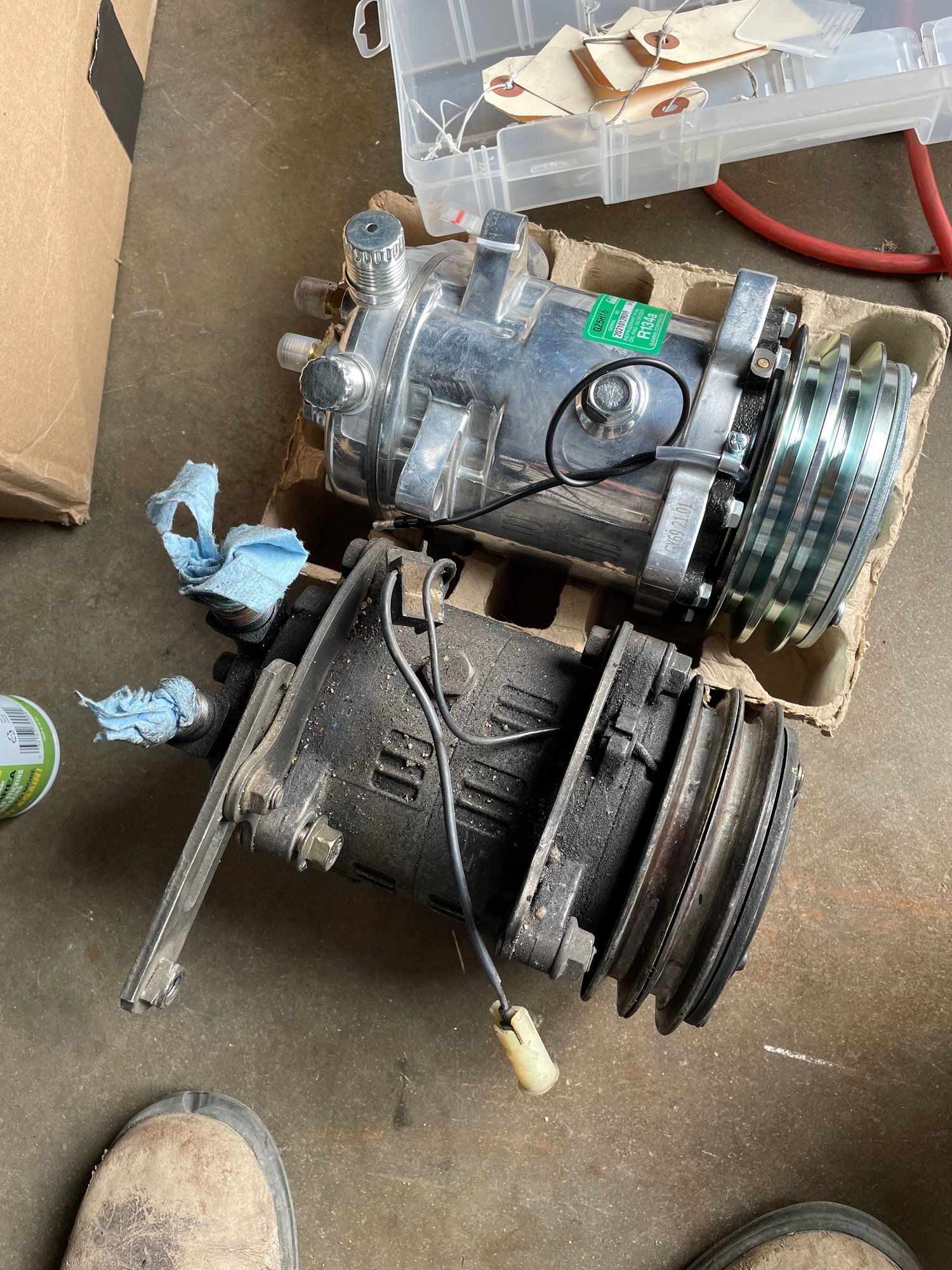

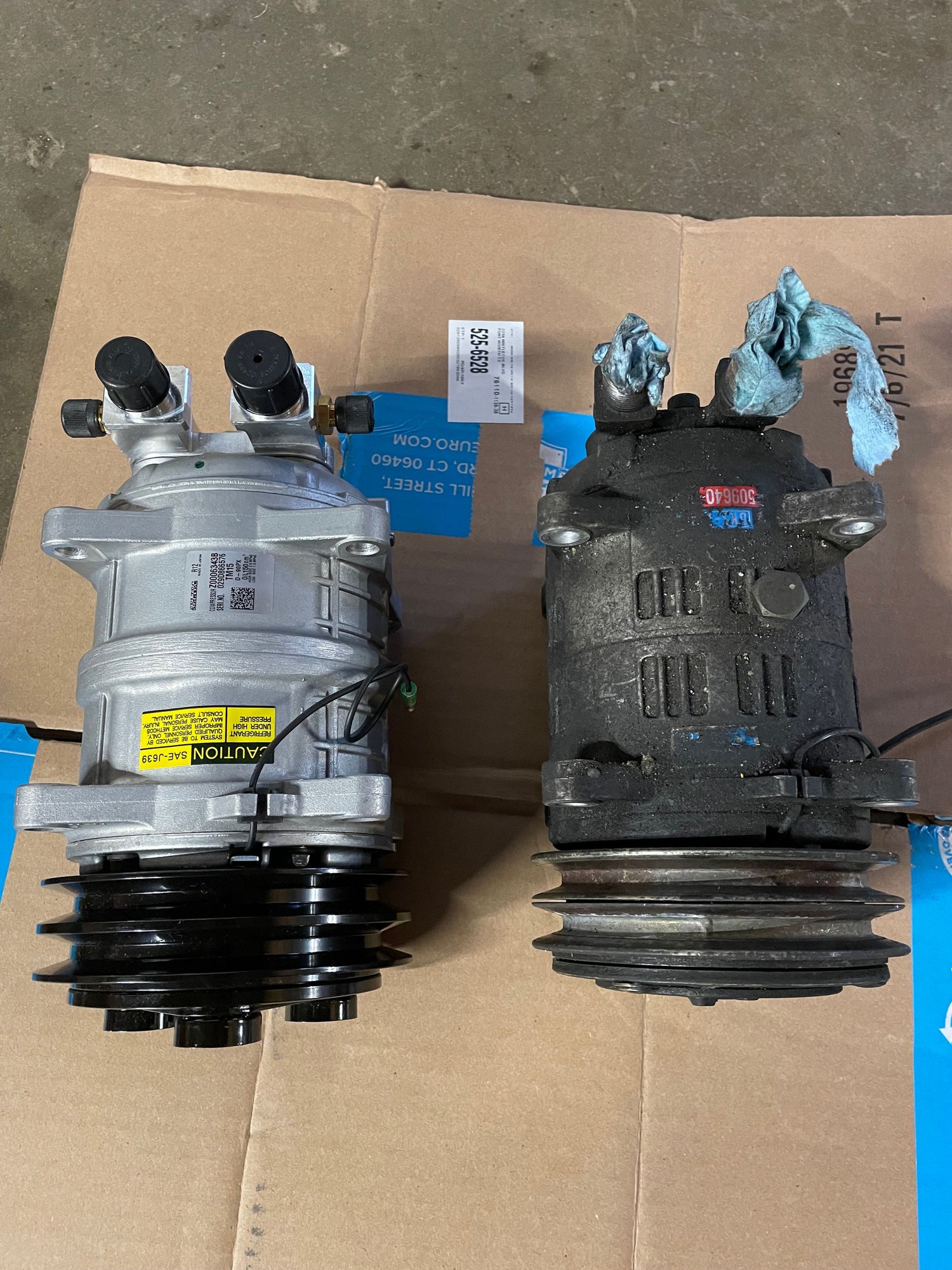

Here was my biggest mistake on this job. I ordered a cheaper replacement "kit" supposedly for the 1992 240 that included compressor, dryer, o-rings, and orifice tube without paying close attention to the photos of the compressor. When I got it, the compressor looked slightly different. The mounting ears were all in the right place but the inlets were cocked at a slightly different angle and there was a bit more to the body in the back. Thankfully I test fit it before I filled it with oil and found that the high pressure line from under the car could not be attached. I packed it all up and sent it back - luckily in time for a full refund. The next kit I got was much better. A made in Japan unit. It looked the same and fit the same. The second compressor came from Parts Geek.
Here's the one that didn't work.
