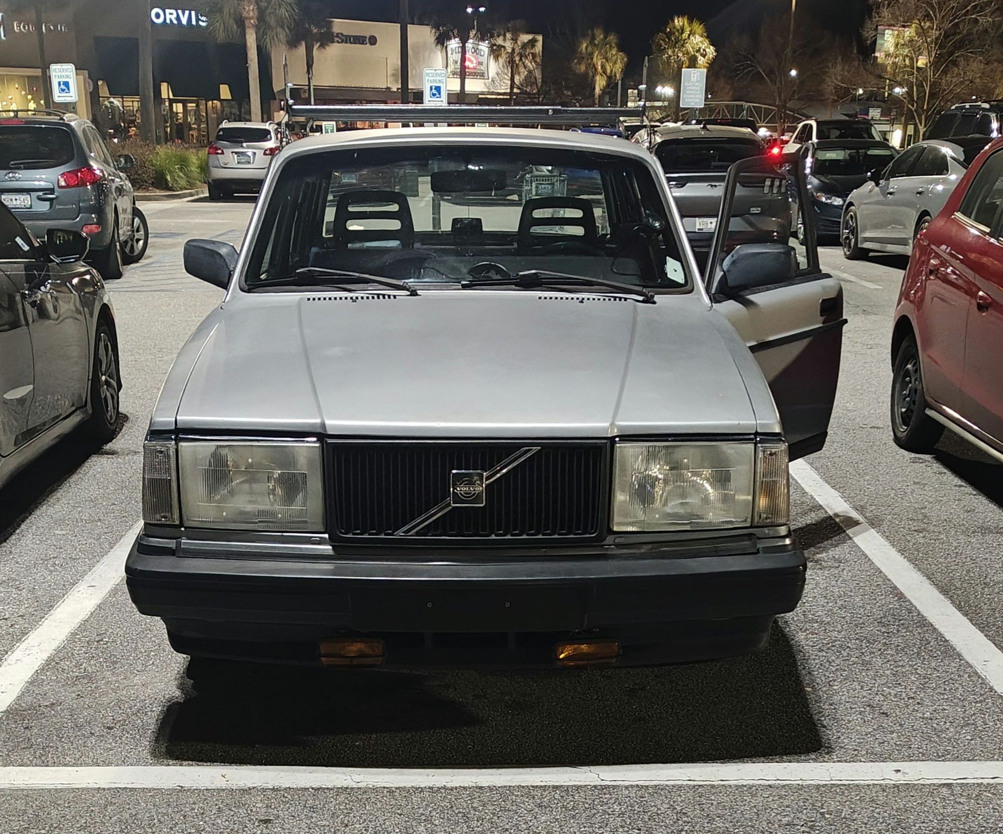

Hey guys! So I have something thats leaving me scratching my head.
I have a 92 Volvo 240 (B230F, AW70) That has a weird Bog/Hesitation on hard acceleration from idle.
All sensors and ignition components have been replaced with iPD parts. Along with a new fuel tank, Lines, Pumps, Etc.
Nothing has changed the bog, It idles great and I get decent MPG (21-23mpg), But that Bog makes it a pain at stop lights in downtown. I checked the ignition timing and found that you cant change it with the distributor (ICM moved it around too hold it at the first timing mark), So it can't be that. What else can I look at? It does it both in gear and in park/neutral. Even if im already rolling it will bog.
My precious Brick in question
