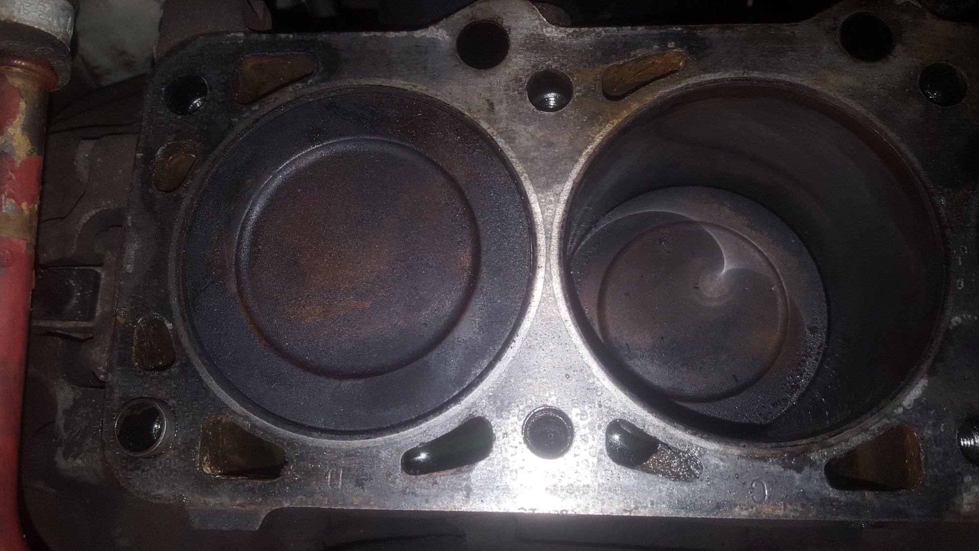

UPDATE: My son wanted to drive into the city for a concert and the car totally shutdown and was able to start up again 20 minutes later. He went to the concert and made it almost home (1/4 mile away). Had it towed home and found out there was no antifreeze in the reservoir. The car had been exhausting a little white smoke. I added antifreeze and he was able to drive it to school and work, but a great deal of power was lost now. So I decided to check the cylinder head gasket. Here is what I found:
1) thermostat was broken (replacing it)
2) water pump was rusted but still kind working. (replacing it)
3) lots of rust in the fluid. (Replacing with Pentofrost NF after several radiator flushes)
4) Calcium build up in cylinder head ports - lots some ports totally blocked.
The reason the car was constantly running rich, I think, is because it could never get to a good operating temperature. Plus the antifreeze was mixing in the cylinder heads causing the white smoke. Probably a lot more was going on... Once I get it all back together I will be running distilled water w/radiator flush through the engine several times, until it is clear. Then I will fill it up with Pentofreeze NF. We might just have a brand new Volvo.
Sending cylinder head to Napa to be resurfaced ( $95)
Attaching pictures.
Compare new head gasket to old. Wow!!
Going to clean the surface with plastic scrappers to make it clean again.
Look at the deposit build in the ports. One was totally blocked.
Wow!! this was so clogged before I cleaned it a little.
I hope Napa does a good job cleaning it up.
If everything goes well, I will have it back together Wednesday.
I know know so much more about these Volvos now....
It is still fun... so far.
