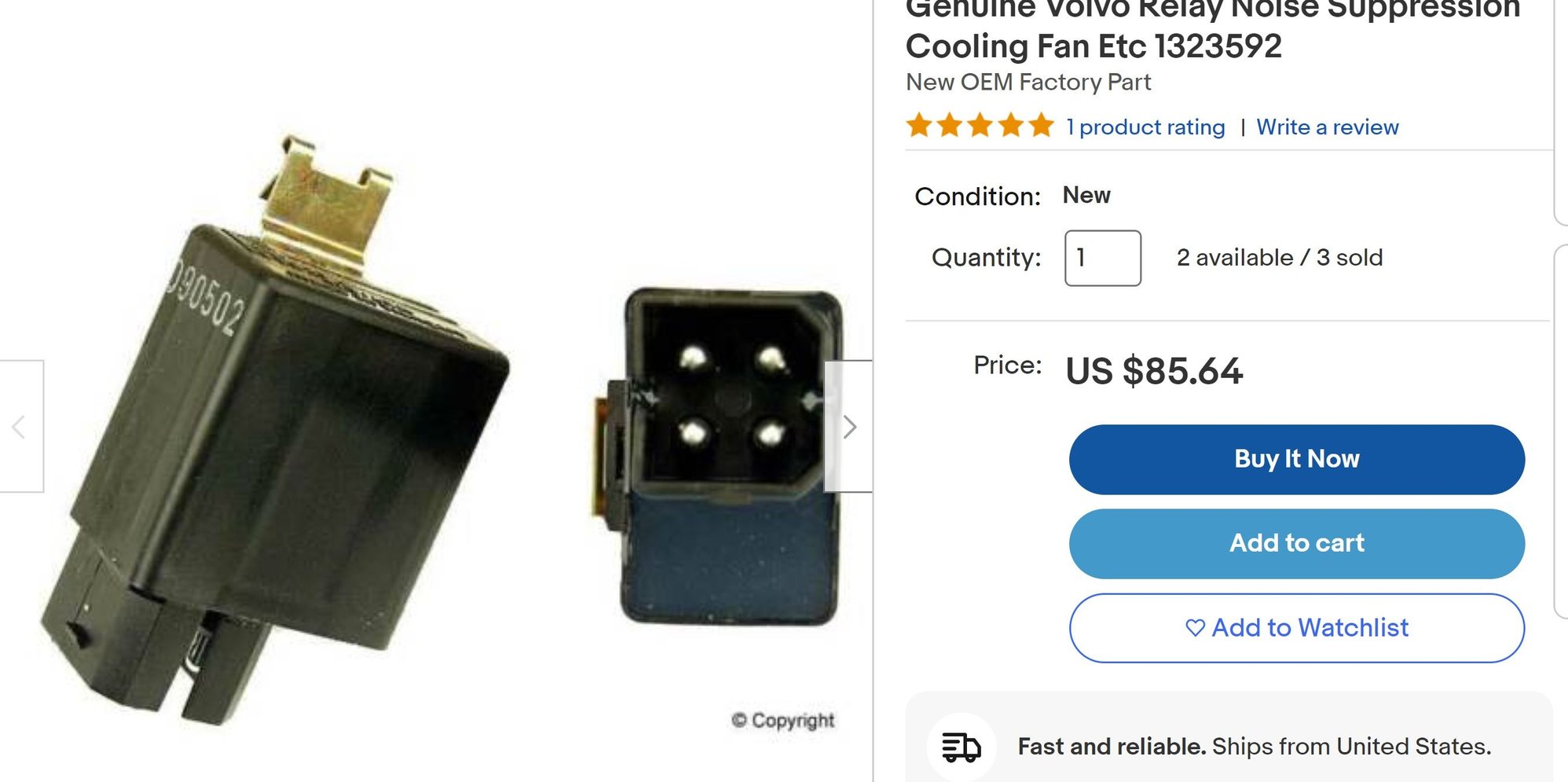

Are you aware of the noise suppression relay under the hood that supplies power to the injectors? Commonly solder joints crack and cause the injectors to stop working.
Resoldering or a new relay can solve that problem. Located under the hood near the power steering reservoir. Black relay with 4 round connectors.

Thanks for the input - it was the first thing I replaced since I thought it was a power issue. I call it the Radio Suppression Relay aka RSR but you're right it's the Noise Suppression Relay.
