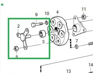

Sounds driveshaft related - are the two driveshaft sections still original and aligned correctly? Should be markings to line up the sections.
The "judder/hopping" when accelerating in first gear could easily be from the driveshaft - Don't remember the 940's as well as I do the 240's - on a 240 when the differential bushings, especially the upper control arm bushings would wear out - the diff would twist toward the ground when accelerating forcing the Ujoint at the diff into a bad angle - causing vibration problems.
On a 940 the bushings in the green squares prevent the diff from twisting under acceleration. On a lift - pull the driveshaft up and down at the rear ujoint to see how much movement is allowed by the bushings.

Woring control arm (rear) bushings will aggrevate the judder when first accelerating. I trust the alignment pin and bushing is there on the front rubber joint. And I would make sure the driveshaft is in a straight line -

Alignment pin and bushing are there. I moved the center support bearing downwards 6mm to get the propshaft in a straight line, which made no diffrence at all to the noise/vibration (the car is not raised or lowered).
