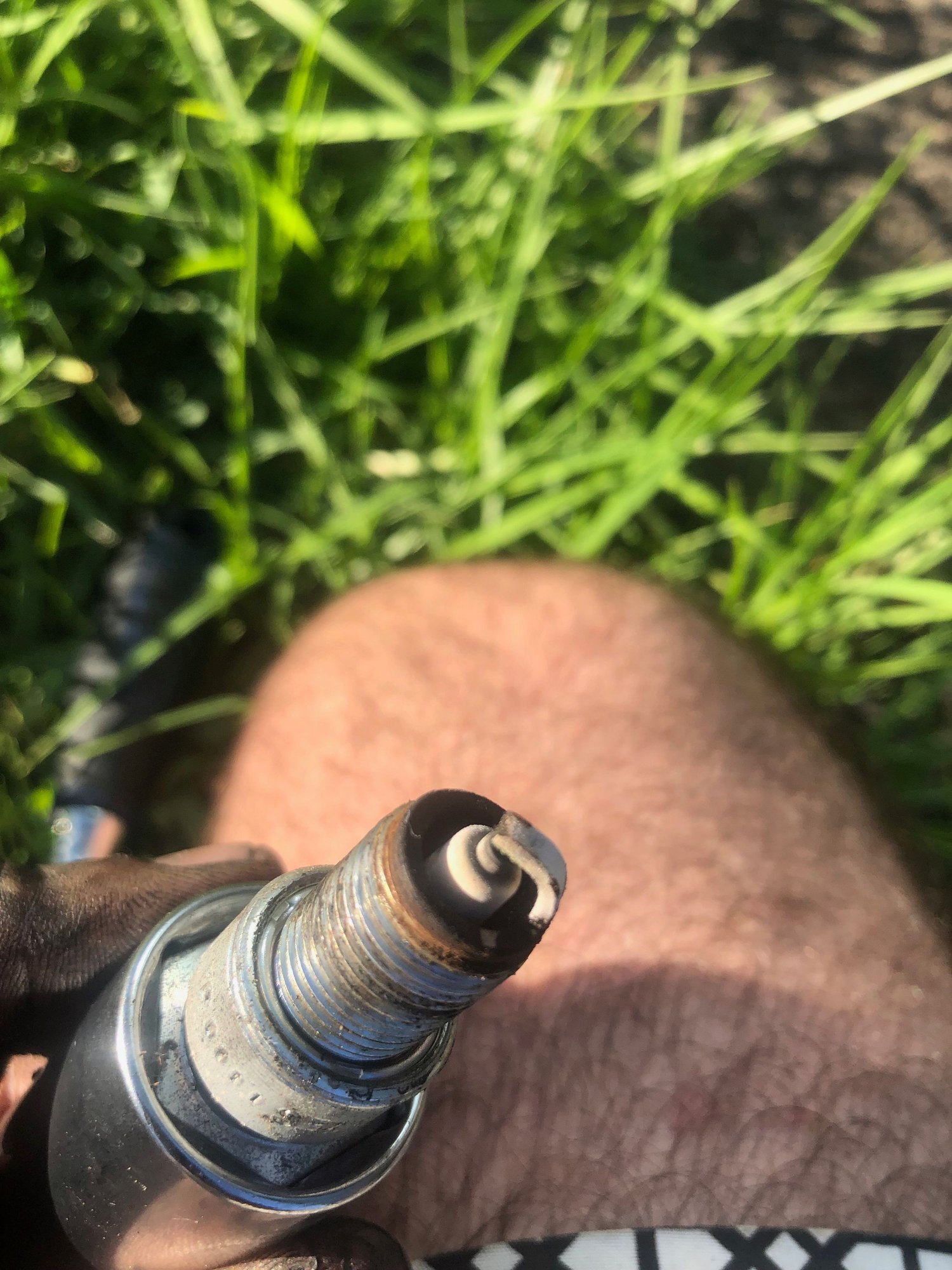

you could pull a spark plug.. see what condition it is in...
Plugs looked ok.
Granted - I only pulled out CYL 1 to have a look - but I have a spare set ready to go in.
I may look at all of them and see what they look like and just replace them
