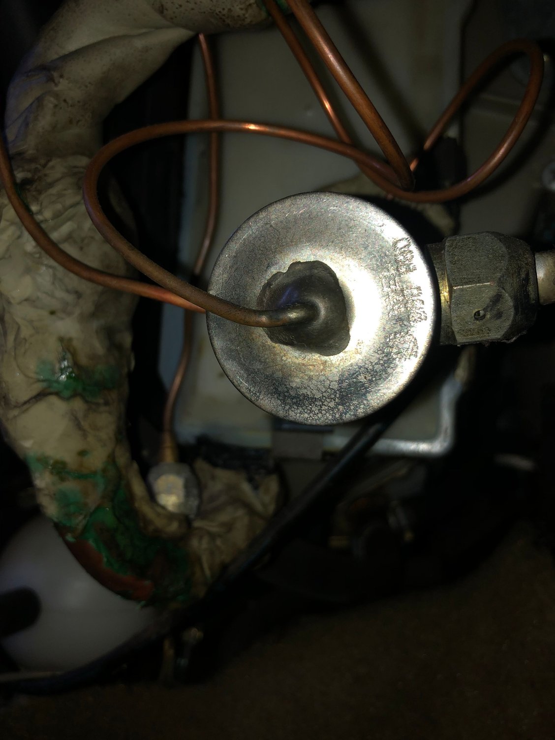

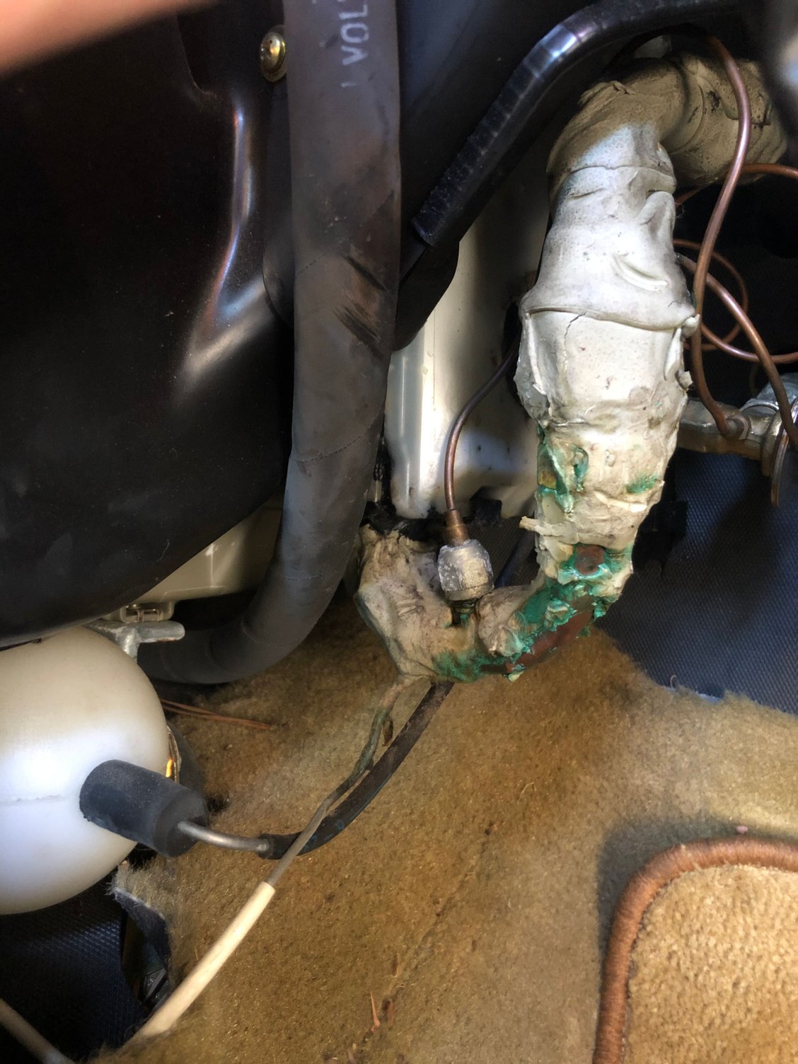

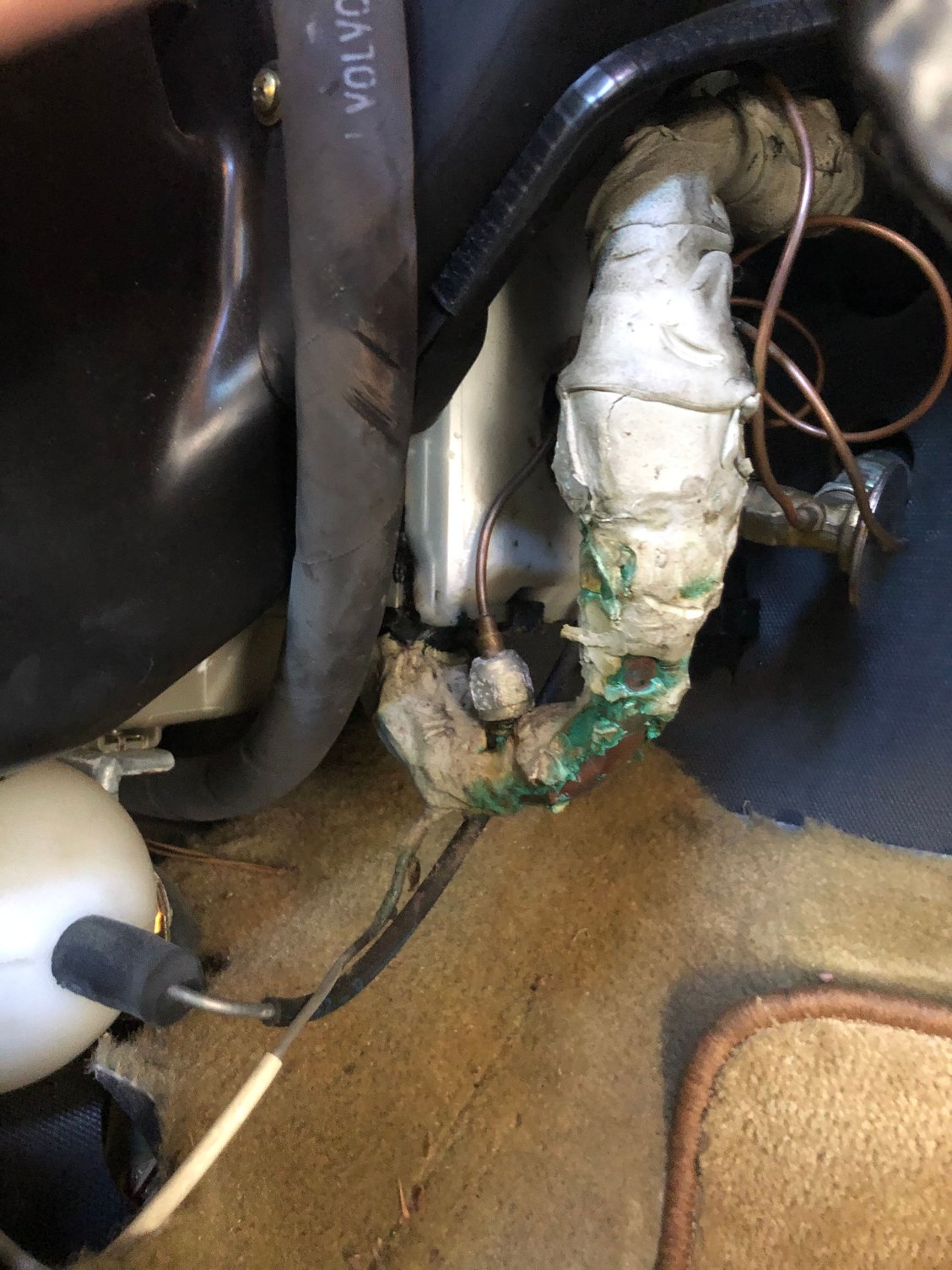

A lot of corrosion and parts i do not recognize. What am i looking at here. This is from the passenger side

The wrapped piping you see is for the AC. The black hose on the left is for the heat. Both heater hoses come through the firewall on the drivers side just above and to the right of the gas pedal. That is where the heater control valve is as well - which is more than likely your problem.
